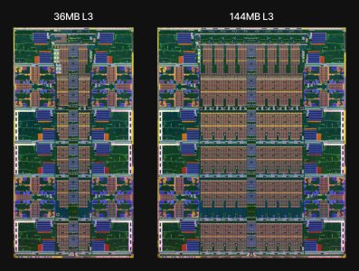

I think the monolithic approach is indeed more expensive to produce, but it's probably less expensive to design... in terms of time to market that is. Intel is still a slow, reactive beast, they're trading cost efficiency for relevance in the consumer market. It will only cost them a few hundred engineer jobs. /s
Just for the fun of it, here's a very crude vertical multiplication of the sections that contain L3 on Arrow Lake. It's obviously not accurate, but fast to put together, and puts the big cache die at just under 1.6x the ARL compute die size. Napkin math says this means a more realistic layout estimate would fall under 1.5x area. If the vanilla NVL-S ends up around 95 mm2 then BLLC version would be ~140 mm2.
Then the comparison with Zen 6 + V=Cache would be:
NVL: 140 mm2 N2
Zen 6: 75 mm2 N2 + 75 mm2 N4 or N6
Reactions: Tlh97 and OneEng2
NVL: 140 mm2 N2
I'm not comfortable comparing rough estimates like this, the figures used for NVL-S were meant to give a sense of scale, not make 1:1 comparisons with Zen 6. I do agree however that AMD is in a position to make the more cost efficient product, at least as far as perf/cost is concerned.
It’s starting to look like a Zen CCD where the cores take up a little under half the total die area lol
That is what I am thinking.
