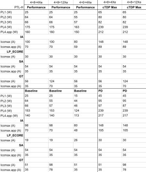

Wildcat Lake (WCL) Specs
Intel Raptor Lake UIntel Wildcat Lake 15W?Intel Lunar LakeIntel Panther Lake 4+4+4
Dies2223
Threads12688
Max Clock5.4 GHz?5 GHz4.8 GHz
L3 Cache12 MB12 MB12 MB
Size96 GB32 GB128 GB
Bandwidth136 GB/s
RTNoNoYESYES
EU / Xe96 EU2 Xe8 Xe4 Xe
Max Clock1.3 GHz?2 GHz2.5 GHz

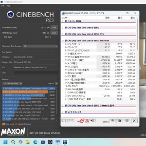

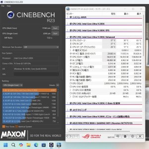

So am I calculating this correctly? I see the IPC of the P cores (2290/1685)raw score / (5.7/4.6)clockspeed margin or only about 10% IPC margin for the P cores?
Edit: This is based on the single core values.
It comes out the same if you use the multicore score:
P core = 17463/8 = 2183 per core
E core = 25728/16 = 1608 per core
IPC ratio = (2183/1608) / (5.7/4.6) = 1.36/1.24 = 1.10
Of course the real performance difference is still 36% more for P core, since the E cores cant match the clockspeed.
I wonder what the power consumption is for 8P vs 16E?
