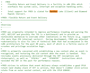

But they added FRED :) "Flexible Return and Event Delivery"
Fred improves performance simplify the handling of system calls, interrupts, and exceptions by replacing the traditional IDT, GDT/LDT, and TSS. FRED eliminates the use of Rings 1 and 2, making Ring0 strictly 64-bit, and introduces new instructions and MSRs for event delivery and stack management
