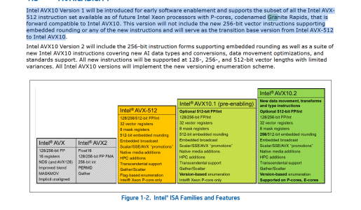

Sure, but if AVX10 does not provide some of the AVX512 instructions then it does not make it a subset if at the same time it provides some stuff that isn't in AVX512 - they may intersect to a large degree, but being a subset is pretty much all in situation, that isn't the case here.
I haven't actually looked at all the supported instructions, but it's my understanding that the first iteration of AVX10 (IIRC this will now be 10.2 as 10.1 is being skipped) is just bringing most (but not all) of AVX512 to cores that don't support 512b wide instructions. There aren't any additional registers or instructions planned. It's not really a new AVX, it's a retrofit to allow for non-512b supporting cores to run AVX512 instructions.

How much area and extra power would they sacrifice vs something like AVX10?
The act of supporting 512-bit instructions is what adds to the cost. AVX10 won't change anything in that regard.
This is why I think they should have ended it at 256-bit and leave the rest to GPUs. Before the 10nm debacle Intel hinted at adding even more ridiculous 1024-bit support. Imagine the problems they would have had then!

They are solving their OWN problem. AMD doesn't have the problem of AVX-512 not working on their E-cores. And if a point comes where AVX10.2 support gives a decent enough boost, AMD will have a CPU ready with support for it within 2 to 3 years. AMD hasn't been sitting still since 2016.
Make it 3-5 years 2 years is short
511
Jul 12, 2024
5,442
4,869
But they don't need AVX10 to do that. AMD supported AVX-512 in Zen4 just fine . . . except of course, as @desrever said, Intel gonna be Intel.
You know how fragmented AVX is they add an instruction in AVX it may be available in 256b only or we will have AVX-512 only implementation.
Intel can remove the features at will(VPintersect) with AVX10 a higher version is guaranteed to support lower version plus new feature and the will get rid of the crap you can only instruction at this width it will depend on data path supported on CPU the issue everyone pointed out is that of data path is 256b vs 512b on AMD

Yeah, they clearly don’t want to even do double pumped 512b support on the E-cores, so this is their path forward.
That's just dumb.
Something that is feature-concurrent with Granite Rapids should support every instruction that anyone could ever want within the AVX/2/512 standard(s).
Removing features is exactly what they shouldn't be doing, since that leads to more fragmentation (albeit at the implementation level rather than the ISA level).

That's just dumb.
yes but Granite Rapids supports the most latest ISA Featured Core and also it is the first Intel core to support AVX 10.1/5121735628837447.png
I agree but the mess they have created with AVX 2/512 with AVX10 it is being sorted the last thing is data path that we all agree should be 512bits.

I think they will agree on APX, which is genuinely useful stuff (more general purpose registers is always good), and AVX10 is likely to be Intel only in my view.
I don't know if anybody else noticed but Intel is now bastardising AMX too - on future SKUs they got something AMX-AVX512 ops, possibly supporting wide 1024 bit tiles they've got in AMX
APX for sure. I see no reason at all for AMD to support AVX10 since it will simply run on the 512b path in AND processors.
Sorry if this has already been answered, but is there any particular reason why Intel can't support AVX-512 on all their cores using double-pumping tricks?
Nope. Intel could have doubled pumped P cores and quad pumped E cores. From benchmarks OF Zen 4 vs Zen5, I think P cores will only be getting 70% the performance of full 522b registers, and E cores only about 40% (SWAG).
It actually does cost fair bit of transistors/power for the extra registers even if it's double pumped,
Only if you have the 512b path. Otherwise, I think it is minimal.
It will allow Intel’s E-cores and hybrid CPUs access to some good AVX-512 instructions.
Yes. AVX10 Gives Intel a good portion of the benefits of AVX512 without the big transistor budget penalty.
If AMD were to introduce a tiny core with only 128bit AVX data paths, I am sure they would adopt it too. I don't see them heading this direction though. Seems like they are designing for server and adapting to client while Intel appears to be doing the opposite.
AMD will Adopt AVX10/512 bit just like they have done so far mimicking Intel
