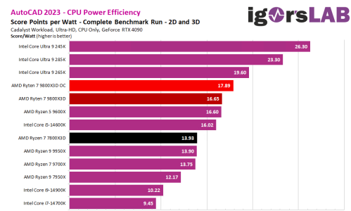

Cheer up, gloomy Intel folks!
Pat's confused CPU team managed to create at least one SKU that wins the efficiency crown in at least ONE benchmark :D
If you remove dlvr the MT power efficiency increases drastically though u have to give skymont team the credit its just they make worse decision again and again probably some product manager
