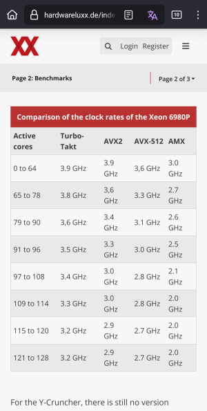

Probably thanks to Intel having thermal issues with their implementation where all-core AVX-512 may have been causing clocks to drop so low that it wasn't worth keeping it on in MT?
Nope it doesn't happen now Only 200Mhz drop before it was severe drop
The problem wasn't strictly that the clocks dropped, but the throttling was based on license scheme. In other words, using any AVX512 "heavy" instruction forced lower clocks for many cycles even if it was only one instruction per 1k instructions. Plus transitions to AVX512 mode was time consuming. The consequence of that was that unless AVX512 instruction were making up most of the program it was better to avoid them altogether. But these problems were mostly addressed with IceLake. And were never present in Zen4/5 to begin with.
DavidC1
Dec 29, 2023
1,833
2,960
Clocks only dropped on 14nm Intel parts, because AVX-512 was too much for the 28 core 14nm CPU. Had they waited a little longer for future processes, it would have been fine. Indeed that is the case with Icelake.
Intel went from 128-bit vectors in Nehalem at 45nm to 256-bits in Sandy Bridge with 32nm, added FMA in 22nm Haswell, and 512-bits in 14nm Skylake.

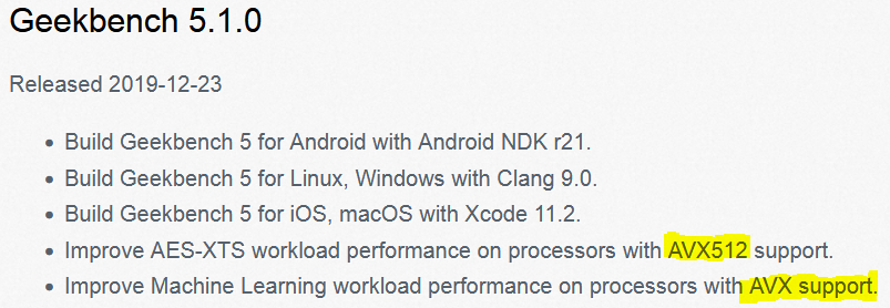

9950X PBO DDR5 6400 with AVX512 enabled in BIOS (2703 / 28719): https://browser.geekbench.com/v5/cpu/23027280
9950X PBO DDR5 6400 with AVX512 disabled in BIOS (2458 / 28569): https://browser.geekbench.com/v5/cpu/23027302
So, AVX512 are only implemented in AES-XTS ST, but not in MT
What likely happens is that ultimately the score (processing speed) caps out when memory bandwidth is exhausted. In single-thread, you do not reach that limit, so you see the AVX-512 boost in the result.
In MT test though, you bump into that ceiling and thus AVX-512 doesn't help - the processor finished the particular code faster, but then it was waiting for the memory, so the end result is the same as with AVX2. The faster execution didn't matter, the score is pretty much only based the on memory bandwidth.
It's the same reason why you can get AVX-512 boost in 1T Cruncher with MT yCruncher showing no or much lower gains.
