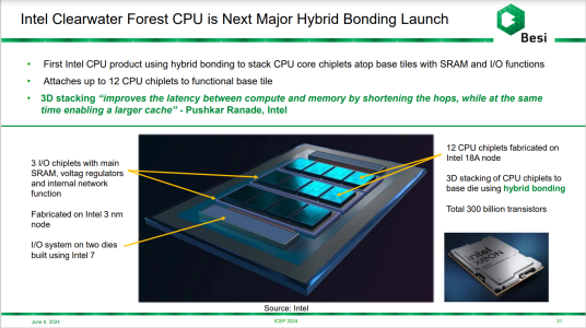

Clearwater forest will do hybrid bonding with SRAM and Imc On Base Tile
Clearwater Forest seems like Intel finally going to get one right.

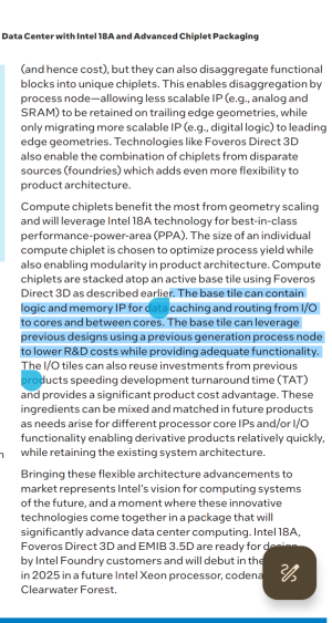

Does it have the memory controller? The Intel page about it doesn't say anything specific. It'll certainly be used to communicate between the dies though.

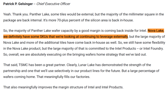

I'm still thinking they'll introduce new tech for the big L3 cache version. They've been talking about it for over a decade now, and it's kinda overdue.
I just went through the transcript of Intel conference call, and in that call, Intel said that some of the Nova Lake CPUs will be TSMC only.
It is a safe assumption that it will be the highest end SKU that will have TSMC compute die, so maybe Intel is planning on putting this 144 MB of SRAM on TSMC N2 or N3...

Yeah, all Intel mesh parts have an IMC stop somewhere.
What is your assessment of that? It looks like Intel has started doing it with Sierra Forrest, including 4 memory channels on compute dies, and then, including 2 or 3 of these dies in the package.
And then, the IO chiplets seem separate, not including memory controllers.
It is a different arrangement, from what AMD has been doing since Rome. It seems like it is not a bad idea...
Nope you got the earnings wrong

No, that's just Gelsinger being evasive, deliberately wording his answer in imprecise way, in order to allow the reader read his wishful thinking into the answer.
I think the translation of the quote is that Intel is going to use Intel's own 18A for all of Panther Lake, but some SKUs of Nova Lake will be TSMC.
And these TSMC only SKUs will be the high end ones, from the context of the theme of the margin discussion of the entire call.
Which would be consistent with "large majority" comment. For example, between 8+16 and 6+8 dies, large majority of product sold is the low end 6+8 die.
