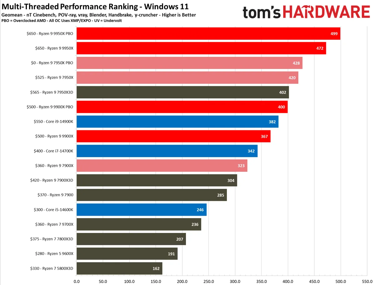

If you look just at the MT benchmarks prior to Arrow Lake they looked like this:
The 14900K still had SMT in 8 of its cores as well, but given that Intel only appears to get 10-15% additional MT performance from their SMT implementation, and the crestmont cores are not a match for skymont (but not that far off either), I don't see how anyone would expect Arrow Lake to best 9950x.
