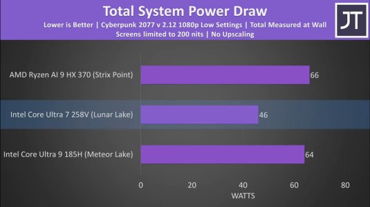

This, this, this. I dont know how many times it needs to be said. Screen size and type are much more significant in regards to battery life and system power draw when you get to these <28W CPUs. But people rather stick to hyperbole without context for their favorite brand.
An what's the difference in W?
I also did a comparison LNL vs Strix, both Zenbooks, even the screens the same from the same manufacturer, the only difference was 2 inches.
I know in some cases 2 inches make a big difference, but are yo saying this is also such a case?

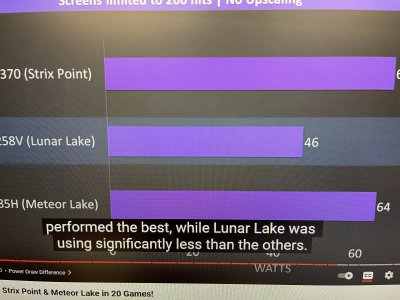

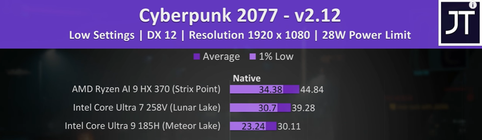

If you watch the full video as you suggest, you’ll see that he set all three processors to a 28W power limit. The graphs you posted are for full system power with different systems and different screens, as has been pointed out multiple times now.

Not true. Additionally, it’s not going to go over the power limit but being at only 28W, the SoCs should be really close in actual power consumption, even if they don’t quite hit the limit. There’s no way the MTL and STX SoCs are drawing 20 extra watts over LNL when they are limited to 28W power.

Then I don't understand the difference in power consumption. Was that some spike or what?
LNL systems are built for power efficiency, not just the processor. It also has a smaller screen, lower refresh screen. There could be some power consumption difference in gaming loads between the SoCs, but with them limited to 28W, it’s not going to be that big and no where near the 20W shown for the full system power difference.
One reason for the difference is that LNL includes DRAM in the 28W power limit. Many like to simply brush that detail aside, but even if you go with a low figure of 1.5W for DRAM that still results in 26.5W for LNL and 29.5W for MTL/STX.

I wonder what did he set exactly for 28W as setting P1<PL2 will result in slightly higher average power draw but in AMD it's usually higher than PL they have some like 1.35X on top of tdp PPT i pressume what it's called so maybe he forgot to set PPT to 28 ?
Yes it should be like 5-7W extra at max not 20W
For sure the 28w power limit was not working.
PL1=PL2=28W or PL=PPT=28W.
Including the DRAM on package is a design choice, it also brings important advantages not just another contributor to package power. You get slightly better memory tuning, you get considerably lower mem controller voltage and Intel also gets to ensure all chips have LPDDR5X 8533. The price they pay by lowering max available package power is arguably more than made up by higher memory performance in combination with around 100mV less voltage needed to drive the memory chips.
Nobody brings up the advantage of having mem on package when comparing battery life, because it would be absurd to penalize LNL for an advantageous design choice. The same applies when scaling power though, it would be absurd to penalize Strix, MTL or even the upcoming ARL-U for their design choices.

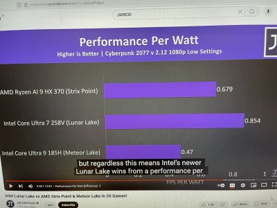

Hilarious! HX 370 sucks! :tearsofjoy: Looks like Lunar Lake is king of performance-per-watt in gaming too!
