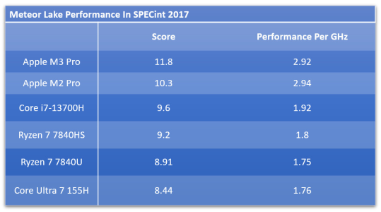

Wrong. MTL has clock regression of around 4% to 5% over previous gen equivalent sku that you haven't taken into account. Once included, the *overall* performance regression of MTL is only around 4% to 5% over previous gen equivalent sku, which includes both tile penalty *and* IPC regression combined.
I don't have the exact numbers (maybe other can help shed some light), but the MTL tile penalty itself is estimated to be around 3% by people in this forum which I too believe is probably close. So, the overall IPC regression (if any) for the RWC core is pretty much negligible.
You're estimate is light-years off from the actual.
It literally says performance/GHz in the chart which is IPC.

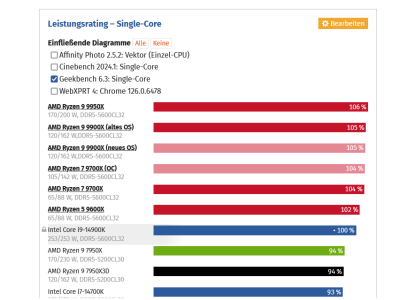

Abwx
Apr 2, 2011
11,942
4,920
True & very true. But even if we consider a meager 5% increase for ARL-S top sku over 14900K in GB6 ST, it's still a few percentage points ahead of competition top sku 9950X.
A few negative percentage points eventualy, because the 9950X is 6% ahead of the 14900K in GB 6.3 ST, and before you ask Computerbase s 14900K score 3236 pts, wich is above GB submissions average.

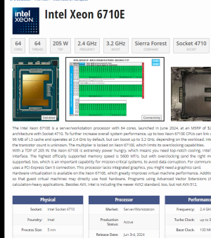

Just noticed TPU making up process node names 😄 It's gonna be funny to see, as cpu generations pass, are they gonna continue making up node names that don't exist? The correct node for 6000E is Intel 3.
