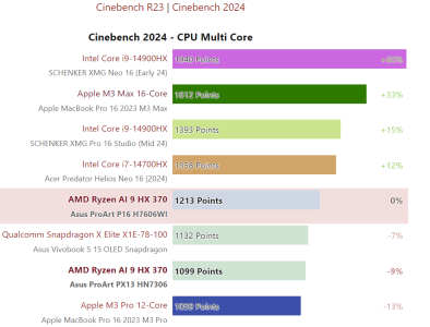

M3 Max does 23800 pts in CB R23 at 58-60W while AMD s 370 does 23000 pts at 65W, overall efficency is comparable, that s more relevant than ST scores, so x86 is as efficient as Apple CPUs at comparable perf.
Beside M3 Max has 16 cores while the 370 has only 12, at 16C the latter would be more efficient, moreover if shrinked to the same N3 process as the former.
At its highest point it reached 59W, but then it’s decreasing as time goes on. The average is thus much lower, around 45W. I suppose if the power draw could be sustained, the score would be a decent bit higher.

At 60W, HX 370 is around 22,293.
Since the benchmark is a sustained workload we shouldn’t be using the max value. But rather the average. At 45W the HX 370 does around 20110-20480 (Geekerwan).
23807 vs 20480 at the same power level is 16pct.
But you’re also not including that the HX 370 released over 9 months later. It’s main competition through its lifetime will be the M4 Max.
And Zen5-R against M5-series.
I will note though, based on GB5 multicore score, the M4 doesn’t really see an improvement in terms of pts/core compared to M3; comparing the iPad Pro to a MacBook Air (closest comparison I could find with fanless devices, IPadOS vs MacOS is barely different in results (1pct higher for MacOS)).
And from what I see in those results the pts/core even within the M3 series goes down as the core count increases. Need CB scores to get a better handle of that behavior.
But obviously based on what we have right now, the M4 is not an improvement over M3 in terms of multicore performance. Will be good to see if that remains the case once the MacBooks come out. But based on what I’ve just noted here, at least in GB5 the M4 Pro/Max would be the same as the M3 Pro/Max EDIT: (as long as core counts remain the same).
Its looks as though ARM cores don't as well in R23 compared to CB 2024. There are considerable improvements in CB 2024.
If we take a look at CB 2024 the %'s changes. The M3 Max takes a bigger lead, yes it has 12P+4E core layout but it also has no SMT. So 16 threads vs 24 threads.
The more fair comparison would be the M3 Pro vs Strix point both have 12 cores but m3 pro has 12 threads and Strix has 24 threads. At simliar wattage they are score simliarly.
