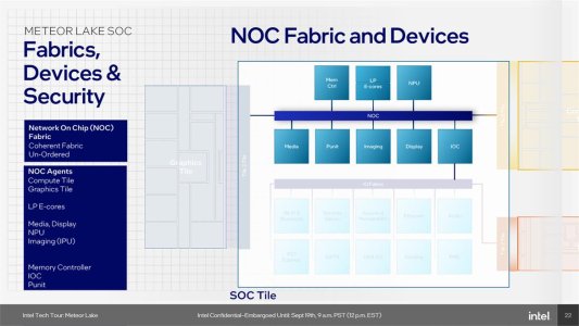

So the mem controller is moved to the compute tile? Because AFAIK MTL not only has the mem controller off the ring, it's on the SoC tile too.
Lunar Lake and Meteor Lake share the same concept: the P-cores (a CPU cluster) and the GPU can be dynamically turned off to save power. That's why Intel moved the memory controller, LP E-cores, media engine, and other stuff to the SoC tile/cluster, which is always active.
There's no big difference in how those structures are implemented: as a separate tile (Meteor Lake) or an independent cluster (Lunar Lake).
In Meteor Lake Intel has introduced the NOC fabric to connect all the blocks:
In Lunar Lake, the structure will be very similar, but in addition to the memory controller, we will have the Side Cache (SLC). It will probably be something like a buffer for a memory controller. That will explain why they are placed closely on the actual chip.
From my perspective, in Arrow Lake, it makes sense to use the memory controller on the ring because there is no urgent need to turn off the P-core cluster or a GPU complex.
But Intel may want to use the NOC fabric on Arrow Lake as well. In this case, we can have LP E-cores, Side Cache, and other stuff on Arrow Lake.
We'll get more details on Intel's decision in August.

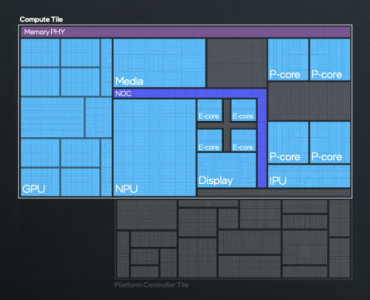

TwistedAndy
May 23, 2024
159
150
@TwistedAndy There's little in common between LNL and MTL except both are using "Tiles" and both are made by Intel. Arrowlake INHERITS Meteorlake's configuration.
Here's the Lunar Lake layout:
We have mostly the same configuration as Meteor Lake with the NOC fabric joining LP E-cores cluster, P-cores cluster, NPU, Media, GPU, IO-tile (at the bottom), and Side Cache as a buffer for the memory controller.
The main difference is the organization of P-cores (MTL has a P- and E-core CPU cluster), the number of E-cores, and the Side Cache, which buffers the memory.
But yes, In Arrow Lake, we will have a CPU cluster similar to Meteor Lake and, probably, with a similar NOC fabric and Side Cache.

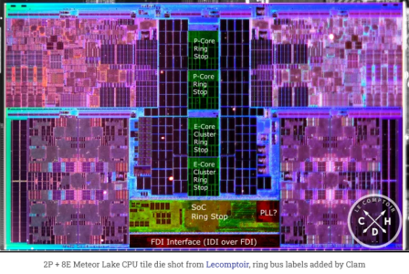

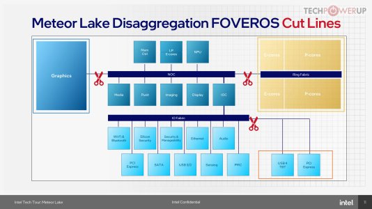

coercitiv
Jan 24, 2014
7,443
17,731
AFAIK in MTL the CPU cores are connected via a ring bus, with the SoC tile having a ring stop to collect traffic that is then passed to the SoC NOC fabric. If this is true, then calling it "mostly the same configuration" is a bit forced.
Granted the part about he SoC ring stop is based on some assumptions by Chips and Cheese, if there's more up-to-date info on the subject it would be great if folks could share a link.
