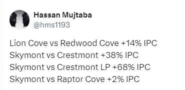

That is from twit
JFC, WTFtech hires morons, I swear. Hassan couldn’t read the dang press slides accurately even when it’s right in front of him.

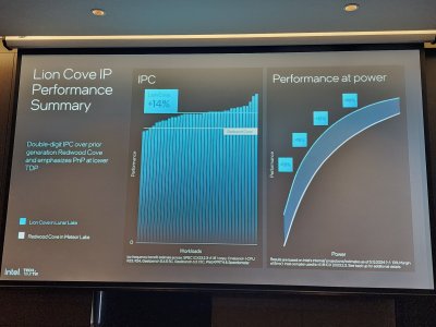

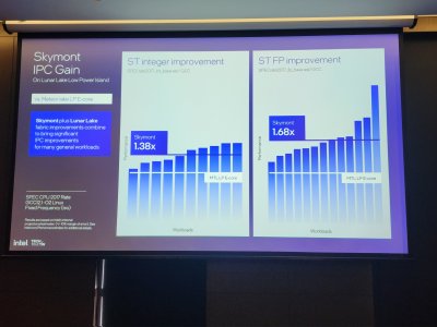

Skymont in LNL with 8MB Memory Side Cache vs Crestmont LP-E in MTL: +38% INT, +68% FP IPC
Skymont in LNL with 8MB Memory Side Cache vs Raptor Cove: +2% INT/FP IPC
Lion Cove in LNL vs Redwood Cove in MTL: +14% IPC, perf/W varies from +18% at lower power to +10% at higher power

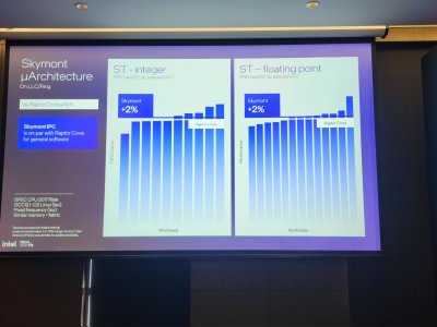

That is Skymont with LLC and on a RING. I am 99% sure that is Skymont from Arrow Lake. Where it sits on the ring bus and has access to the L3 cache.
Where are you getting that from? It's talking about an SLC, not the regular ring-connected distributed L3.
Edit: Yeah, looking closer at it, I see now. Mea culpa.

Jun 4, 2024
You can't read the slides either :)
The vs raptor cove is not Lunar Lake LP Skymont vs Raptor Cove, but an undisclosed (Arrow Lake) implementation where the Skymont cluster is on the ring bus (and shares L3 with P-cores)
