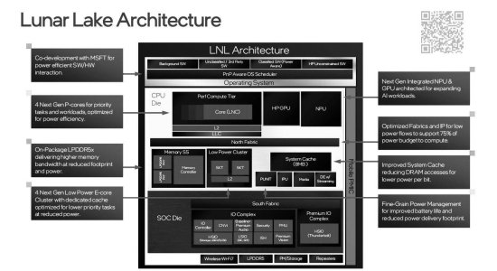

For the MT comparison it's 4x Skymont in LNL vs 2x Crestmont LP in MTL.
Why do you insist that LPE cores in LNL is equivalent to LP Island cores in MTL?
There is absolutely no indication that they are functionally the same.

Yeah that's not an L3 cache.
So what? For low priority tasks you don't need a low-latency caching subsystem. So the SLC can be away from the cores, and maybe even clock differently to save power. But it is a "Last Level" cache nonetheless.
It is increasingly becoming clear that MT perf of Skymont is being compared with Crestmont at the same core counts.
Kepler_L2
Sep 6, 2020
1,081
4,674
How is the MT perf increase so much higher than ST perf increase? A puny 8MB System Level Cache is not going to result in 70% higher performance.
Lower MT frequency penalty vs Crestmont due to differences between N3B and Intel 4 is one possibility.
The other one (and more likely) being that this isn't a comparison with Lunar Lake as the underlying SoC, but Arrow Lake.
In which case it will be an apples to apples comparison with both having access to LLC.
