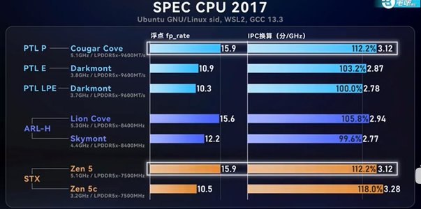

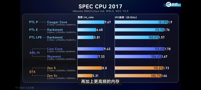

Let's unpack this.
I think you are referring to the SPEC 2017 results?
They showed Cougar Cove +10% over Zen 5 for INT and even for FP.

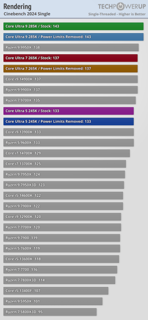

In spec int the 358H with 8533 RAM is at the same level as a cut down cache KRK AI 350 using 5600 RAM, what about if RAM speeds where the same, so from where did you pull those 10%.?.
As for FP is your reference Cinebench.?.
Because in all other renderers Zen 5 has better ST IPC than the 285K.
Edit : At 5.1 GHz the 9950X would do 11.27, that s 9.4% better than the 358H, seems
that you got your numbers completely inverted.

Hulk
5,379
4,092
I pulled them from these, which are in this thread.
Also, Lion Cove seems to be a little better than Zen 5 in CB.
