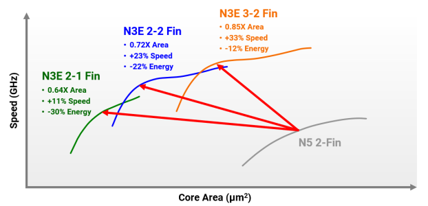

The third and fourth slides seem to indicate single-threaded and multi-threaded perf-power curves respectively.
In ST, Skymont can have 1.7x higher performance vs. Crestmont at iso-power, or 1/3rd power at iso-perf.
In MT, Skymont can have 2.9x higher performance vs. Crestmont at iso-power, or 1/3rd power at iso-perf.
Note that the comparisons are being made at the maximum power scaling point of Crestmont, meaning that relative performance of Skymont vs Crestmont would be even higher at very low power.
For the MT comparison it's 4x Skymont in LNL vs 2x Crestmont LP in MTL.
