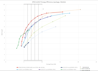

How could the 7840HS score be that lower than the 7840U at say 7-10W, this is exactly the same chip so it should have the same power/perf curve in this part of the graph.
Different SOC power, binning and preset voltage/frequency curves for yield, etc etc
Those are just the default 1t speeds of the respective CPUs. Where is this IPC scaling chart for RPC? At least according to the slides in the new video, RPC scales in IPC slightly better from 3.5 GHz to 4.7 GHz than RWC core scales from 3.6 GHZ to 4.4 GHz.

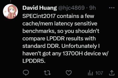

I think I see your point now. This is what Huang said.

You didnt even look at the data, that just a remark out of clulessness; so much for the clownesque argument...
The slope of its power/perf curve is just plain fairy tale since there s a segment where perf increase about linearly with power, whoever doesnt notice such a discrepancy is not qualified to comment the rest...
It’s a different gear for the memory controller.
Lol, you dont even know what you re talking about and are inventing difference that do not exist or at least gigantly overestimating the eventual tiny differences.
7840HS is the the same SoC as the 7840U and has same V/F curve, there s no binning that could result in such a vast difference, at 10W FI they should both be in the same curve but guess that when one is cluless about CPUs he s unable to spot even an elephant in a room...
Genuine Question: Then does AMD do no frequency binning at all for Phoenix?
massive 🤡 take
two CPUs can have the same SOC but have different uncore frequencies and V/F curves because they are targeting vastly different power levels.

Use less emoticons and more neurons, there s no CPU whose power can increase linearly with frequency.
The 7840HS has the same V:F curve as the 7840U, the difference between the two is that the former can be set at powers above 35W, this wont impact the V/F curve at the lower power range, actually the data about the 7840HS is bs and this cast a big doubt about the source s competence.
Ye, the guy spent a thousand dollars on a SPEC licensee, went out and tested tens of machines, is incompetent, because the data doesn't hold up to your idiotic scrutiny, that the 7840hs and 7840u simply just can't have different v/f curves or different uncore presets lmao
Keep coping 🤡
They have the same vf curve at low power, it s just that the 7840HS can be pushed at higher powers.
If this curve was right then it would mean that in MT with all 8 cores loaded the 7840HS woud use say 30W while the 7840U would be at 15W for a same Cinebench MT score for instance, that s just ridiculous...
Because that s basically what is displayed here, the 7840U is 2x more efficient in the lower power range, so it would still be so with all cores loaded at base frequency and something like 4W per core at most.
You’re missing the differences in both memory and fabric speed. The 7840HS is DDR5-5600, 7840U is LPDDR5-6400, both are running the fabric at different speeds (i.e. gears).
That wont change things at that throughput and power level, beside we re talking of CPU package power, not full system power, the RAM has nothing to do here.
At base frequency each core take few watts, so just imagine the huge differences there would be between the HS and U PHX at say 30W with about 3.5W/core, one CPU would score 50% better than the other in MT at this power.
At some point when the discrepancy is that gigantic it s better to think about it rather than bringing infinitly small details with very few influence as likely explanations...
While I'm not certain what exactly is being measured, I doubt it's just CPU package power. The 155H e-core power at 3W compared to 5W for the 155H LP e-core is the clearest example of such. Combined with the difference between 7840HS and 7840U I'd guess that the power figure also includes memory, potentially even full system.
There are three key differences between the 155H e-core and LP e-core - manufacturing process, frequency/power optimization, and cache. The manufacturing process and frequency/power optimization point probably end up with the LP e-core being just about as efficient as the e-cores on the compute tile, maybe a bit ahead. But the LP e-cores lack access to the L3 cache which may well be resulting in far higher memory utilization for the SPECint 2017 benchmark? That could explain the much higher power numbers.
Meanwhile between the 7840HS and 7840U traces the key difference is DDR5 5600 vs LPDDR5 6400. The DDR5 5600 is going to be slightly lower speed, but much lower latency and higher power. Which is exactly what we see in the different traces - shifted right by about 2W (higher memory power) and slightly higher performance (lower latency memory.)
I honestly think it's just worse power management on the SOC leading to a base increase of like a watt or something. I don't think any of these systems are being exactly tailored with their uncore/core power management for extremely low power consumption either, so that in combination with binning would easily make up the difference.
Zen 4's HS series idle power has been suspect for a while, with tests showing not much improvement or even regressions vs Rembrant in battery life. Infact, notebook check just ran a review citing that.
Plus, I think it's also important to note how Huang might have ran this testing. It's been brought to my attention that apparently you can't control Zen core's power directly, rather what Huang likely did was change package frequency limits or core frequency manually, and record data from there. This might impact the optimization of core/uncore power.
I do also think that your explanation might actually be another possibility though. That can also make a lot of sense, esp since he speaks a different language, and it could be a translation error.
I just don't think Huang pulled the data out of his butt lmao

You are unable to analyze the data, hence all what is left is to ridiculously brand someone a fan boy because of your limited knowledge.
From 7 to 12W the 7840HS score increase from 4.3 to 8.5, that s almost 2x the perf for 1.7x the power, so thats just a first point of total bs.
What is displayed is that with 8 cores loaded using each 7W, that is 56W, a 7840U would perform 62% better than a 7840HS, yet another prove that the 7840HS curve is totaly made up, no one serious with minimal knowledge would deem it as being credible.
I think the data is legitimate, he’s just annoyingly not providing all of the data points as I’d like to see them.
How so? I'd agree if the 7W to 12W power figures were for the single active CPU core executing the benchmark, but that's clearly not the case. Given what I know of how these curves look, the active CPU core is probably in the 1-2W range for the 4.3 score and 6-7W range for the 8.5 score. That's 3-7x the power for 2x the performance.
That would be the case for all other CPUs as well, and particularly for the 7840U, why would the 7840HS uncore use 3x the power while it s the same CPU..?.
If you look at some reviews the 7840HS idle power is the same as the 7840U, difference is the power at wich it can be boosted, since the 7840HS can use roughly 55W it will consume more when loaded with a lot of threads, but in single core it use the same power as the 7840U.
As i already said the 7840HS curve is boggus, there s a mistake that has been done by the guy who did the tests, there s no other explanation.
For the other curves that s another story, but given the blunder for the 7840HS i would be cautious to not take the rest at face value.
There are plenty of plausible explanations which have been provided in this thread.
I certainly won't claim that it's well presented and complete data. In fact, that's the primary reason why it's problematic to definitely state that there's a problem with any of the results. Certainly would be nice if there were reliable public sources for such benchmarks.

That quote for that website is either AI generated, a bad translation, from an author who doesn't really know what he is talking about, or some combination of the above.
