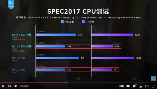

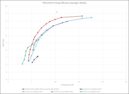

SPECint ST efficiency comparison
SPECint perf graph by same author. IPC regression on MTL is the biggest question mark, tile-base design is to blame?

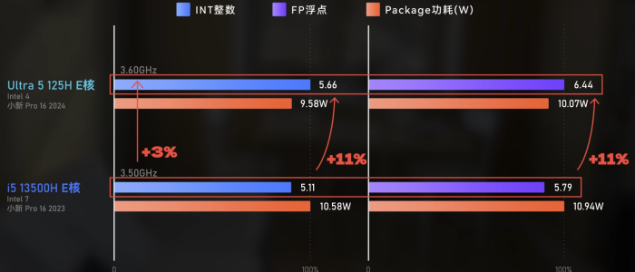

also the normal E core efficiency is good thanks to architechure changes:
There is no such thing like 155H LP P-core.
There IS. MTL has two different type of P core, one of the P core has lower voltage than the original one. Yeah I think it is a painful design.

What? You mean E-cores, right?
He says MTL has two P-cores because of 8VT/6VT Intel 4. The question would be how this works and what core is using the more efficient 6VT. It would make sense the two 1T cores are on 8VT because of the 1T Turbo.

Is the source of those Spec_Int charts just the guy on twitter? The graphs seem somewhat strange to me. Also, what is the source that there are 2 different P cores in MTL? I don't remember hearing about this previously. A 10% IPC reduction in the P cores also doesn't seem correct compared to other tests.
So MTL now is believed to have 4 core variations on the die?
mikk is correct about this. MTL P cores has two different voltage settings. But unfortunately not all reviewers knew this.
translate
MTL has two types of P-core, 8VT/6VT, one with high frequency upper limit and the other with low leakage.
Reactions: Henry swagger

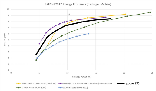

The curve of the 7840HS is total non sense in respect of the 7840U, that s just made up numbers.
>Sees data he does not like
>Calls data made up numbers
Tons of things to potentially blame. Tiles making memory latency/bandwidth/power a "?", spec2017 not liking the RWC's larger L1i cache, I think ringbus frequency got downgraded again? Idk
Finally earning the name of "efficient cores" lol

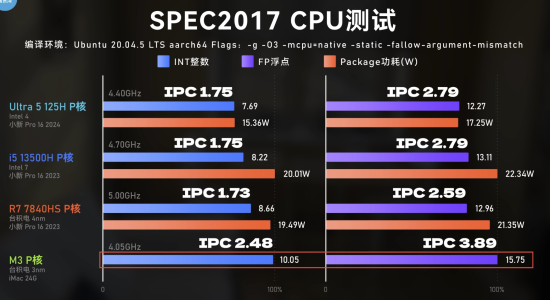

Those Spec results are from Geekerwan and they don't agree with the twitter guy's (David Huang) results.
More relevant screenshot here:
Both show marginal a marginal IPC decrease in INT tests at higher frequencies. Huang shows a 14% difference between the 155H and 13700H, but he isn't testing IPC afaik, just the scores based on the peak ST frequency, so it's comparing a 13700H at 5GHz vs the 155H at 4.8GHz.
Geekerwan finds a 7% difference at 4.4GHz, and based on how that IPC scaling is going, I wouldn't be surprised if the difference is higher between the two cores at the full boost frequencies of the 155H and 13700H.
I don't find anything too dissimilar or fishy.

Oh ma fault, didn't see the edit. Don't know why in these graphs Geekerwan is comparing IPC for RWC at 4.4GHz, and IPC of RPC at 4.7GHz, when his own graphs showed that IPC scaled terribly for RPC between 4.7 and 4.4GHz (<1% increase in perf for 7% increase in frequency)

You didnt even look at the data, that just a remark out of clulessness; so much for the clownesque argument...
How could the 7840HS score be that lower than the 7840U at say 7-10W, this is exactly the same chip so it should have the same power/perf curve in this part of the graph.
The slope of its power/perf curve is just plain fairy tale since there s a segment where perf increase about linearly with power, whoever doesnt notice such a discrepancy is not qualified to comment the rest...
Those are just the default 1t speeds of the respective CPUs. Where is this IPC scaling chart for RPC? At least according to the slides in the new video, RPC scales in IPC slightly better from 3.5 GHz to 4.7 GHz than RWC core scales from 3.6 GHZ to 4.4 GHz.
