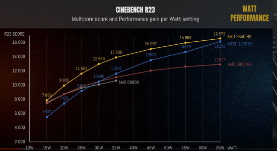

From NBC tests it look like the 7840HS is set at about 35W, the 7840U score about 12000@30W.
Also notice the evolution from R15 to R23, no need to improve your CPU IPC, "improve" the bench instead, that work much better, same from GB5 to GB6...
Edit : The difference between 125 and 155 in battery life is not significant, in the first test it s 3%, so within error margins.
The 7840HS should score near 14000 at 35W.

I really think, if it's legit at all, the Billibili tests were sometimes run on battery power, that's the only way I can explain some of their results.
~15k at 64W would make sense and correlate to the other leak of ~12k at 40W. Both results would basically match up with RPL-H performance and efficiency.

The chart from @Hitman928 shows 13705H at 40W scoring ~12579 pts, which is better than this MTL.
Without knowing PL1, PL2 or the length of CB's run this is just an inaccurate comparison.

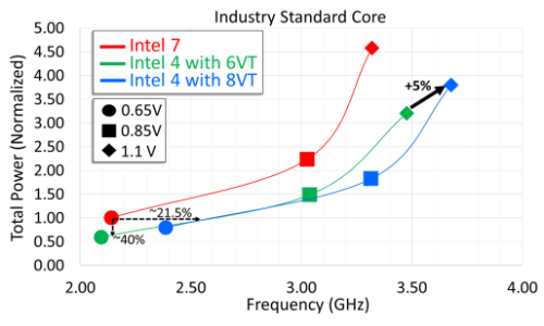

The chips need to run at 4.5ghz+, this chart is useless?
There’s Crestmont cores with an fmax <4.5ghz and Redwood Cove won’t be running >4.5ghz in the 28-45W range.
This is also an ARM core in the chart so it’s not exactly apples/apples but it gives you an idea of what to expect.

If this chart was comparable to reality, then MTL at 3.3GHz would consume ~40% of Raptor. So If Raptor needed 45W MTL would need ~16W at 3.3GHz.
@H433x0n yeah, It's simplified, but I only wanted to show tha the difference is big.
