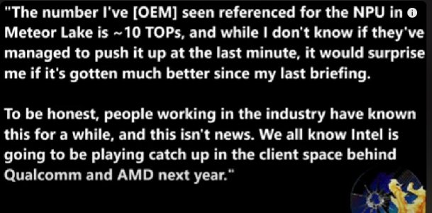

So Qualcomm has the leadership in AI performance at 45 TOPS.
Although not for long, as Strix Point will debut in later 2024.
Hawk Point is the same silicon as Phoenix, it's just a NPU clock speed bump up. Someone should test the efficiency and see how it changed, performance isn't everything. Afaik MTL NPU is clocked at a modest 1.6 Ghz which results in ~13 TOPs. To be fair maybe this refers to 185H and 10 TOPs is valid for lower models, we don't know yet. Funny how he proudly mentioned Hawk Point is shipping whereas he didn't say the same about MTL. AMD can paper announce something and he is hyping it up with already shipping.
