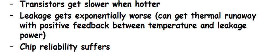

Heat does affect resistance, but not by any measure that would change the timing in a processor. Sure at some heat point the switching frequency will fail, but until then hot or cool it's business at usual.

"Another basic principle of silicon transistors is that they leak current across junctions and to the substrate(Kaushik, 2003). The amount of leakage current in a processor of a particular process type will vary largely by applied voltage and temperature and it can become quite significant in today's high-performance processors. This is because the same factors that are required to make transistors switch faster (i.e., achieve higher frequency) also increase leakage. All this leakage current creates additional power that must be counted as part of the device’s total power consumption. Naturally, leakage power effectively reduces the amount of the device’s total power envelope that can be consumed as active power (i.e., power used in transistor switching that does work)."
Is this not saying that increased temperature will lead to increased leakage power, leading to a decrease in power available for active power, meaning that either A) clocks decrease or B) power increases to maintain the same clock speed?
Yes, but that's not what I asked for.

One dimension neglected in all this discussion is that the peak heat of hotspots in MBA likely exists for just a very short time span. Other manufacturers like Intel and AMD already moved on to reporting running average values instead since people tend to become hysterical about the high values otherwise.
Professors love them some Comic Sans.
And typography professors hate them for that.
It does say that, but you need the rest of the story:
  • leakage power is much smaller than dynamic power when CPU is under load, and then it linearly increases with temperature delta
  • thermal transfer to the cooling system also linearly increases with temperature delta over ambient
The higher you allow the CPU to go in terms of temps, the more power it can dissipate provided the cooling system can take it. This also leads to linearly higher heatsink efficiency, as long as ambient temps are not influenced by the heat exhaust (or the heatsink has some ceiling temp limit due to construction).
Case in point, if a heatsink is able to dissipate 10W when the CPU is only allowed to reach 50C with an ambient of 20C, then allowing the CPU to reach 80C will help the heatsink dissipate closer to 20W. (temp delta over ambient has doubled from 30C to 60C). So even if you had leakage power of around ~1W that gets doubled to 2W at higher temps, the limit for dynamic power has doubled from ~9W to 18W. There's obviously a lot of caveats here, but the benefits of allowing the CPU to reach high temps are big as long as one can do it safely.
