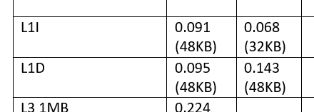

So the point of contention with this leak is the size of the L1 cache. Raichu claims it's 64KB L1D, which is a doubling of cache and would undoubtedly bring a latency impact. Locuza thinks it's 48KB, a 50% increase.
I started doing redwood cove die shot calculations a while back for fun, and if I paid attention I should have caught this earlier lol, but...
(GLC on the right, RWC on the left)
*Note L1I for RWC was preliminary, could be 48KB or 64KB.
64KB L1I could be true I think. While I'm not even close to the accuracy in estimations Locuza can prob bring, I do wonder if he made a mistake somewhere because I am using the same markings for the die shot he created, yet and coming up with way different estimations.

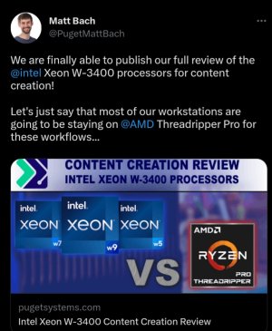

I'm getting major deja vu. Didn't pugetsystems already post a review of this? Not a previw, the actual review. They also included the lower core count models as well. Is this an update? Idk.
Regardless, interesting results. Uses 40% more power than AMD and scores 10% lower still in cb23. Yikes.
Overall, per core SPR looks to be as strong as TR but uses drastically more power, like 40-70% more with the top SPR sku. Don't know if MCM SPR is just extremely bad, mesh just scales terribly, or what it is, because GLC vs Zen 3 in the W2400 series looks to be equivalent in performance and efficiency.
Looking forward to what EMR can bring, because top end SPR just looks bad in comparison to... a what, 2 year old CPU?
On their Preview they used Beta Bios, now they are using Release Bios... Nothing Changed. Distribuiting A Huge Mesh over 4 Tiles is not efficient. That's why Granite Rapids is doing away with it
Locuza confirmed he missed a couple blocks
So 64KB L1 I it is.

So 64KB L1 I it is.
Kind of surprising tbh
I feel like it is a change that makes a lot of sense for Intel. Currently they have 5 L1D cycle latency in GC cores. AMD has 4 cycle L1D latency and is also clocking >5.5Ghz. Is 48KB vs 32KB a proper compensation? I am not so sure.
It's really a replay of ADL having small and slow L2 in GC core that got fixed with Raptor Lake. If your cache is dead slow already, why not make it larger? @ 2MB per core it started to perform real well, due to hitting their horrible L3 ( that was also speed up ) less and suddenly whole chip was better.
64KB of L1D is big change, as long as they don't relax latency further and would feed their OoO monster better. Not hitting their weaker L2, means better perf and less power usage.
The real danger here i guess is decline in Intel's memory subsystem engineering overall, they might complicate latency in Skylake way, they might end up with 6 cycle latency across the board.
