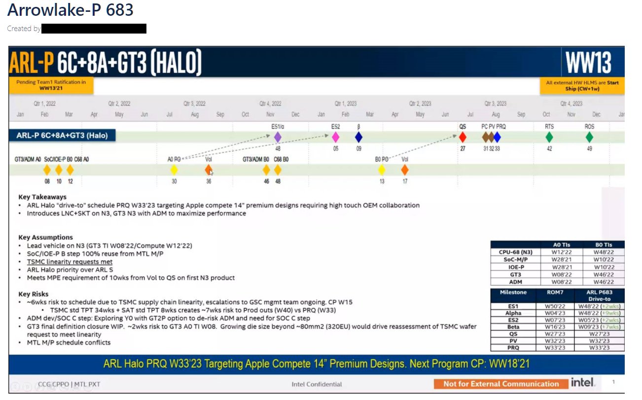

Also idk who wants to wants to go into so much effort as to fake this:

Isn't this a slide for a mobile product? That's the one that's rumored to be on 20A?
Also - Can somebody explain to me how it makes sense to make ARL on both N3 and 20A? These 2 nodes seemingly couldn't be more different. How are you going to carry over an arch with design rules for GAA and PowerVia and port it over to N3 without a significant time investment? This is ignoring it's 2 totally separate PDKs (one for TSMC FinFet, the other for IFS GAA). Looking at it from a high level, it doesn't make much sense.
Edit: From what I can tell, if they make Lion Cove on TSMC N3, you're committing quite a lot to it. It seems like there's 2 options if they decide to use TSMC N3 for ARL.
A) Building all of your compute tiles on TSMC for this generation.
B) Performing the work twice by porting it back to 18A once it's ready, which seems like it'd be quite a lengthy process and by the time you're done you're almost done with the arch anyway.
Ye, apparently Intel switched what segmentation they are going to use N3 and Intel 20A for. One has to wonder why, perhaps they want to use internal node for their high margin and more important lineup of mobile, perhaps TSMC 3nm just has higher fmax than Intel 20A, etc etc
Also if LNC uses two nodes, the ideal reality would be to develop them simultaneously. I don't think the core arch is as 'glued' to the process node as you think it is... specific implantation may help achieve better density or better performance in one variant or another, but I think it's still possible. And tbh, imo, LNC was originally meant for Intel 7nm/Intel 3, but got pushed onto 18A because Intel thought they would have that node ready by then, also because of additional delays elsewhere. But that's a whole other discussion.
When core archs are being developed, I'm assuming architects imagine their node, see what the density/power they could achieve with it, and then add additions to parts of the pipeline accordingly, making sure that they don't "blow up" the core area or have clocks and power consumption be impacted too heavily versus previous gen. IIRC Intel had a general rule of their new archs having a 1%:1% ratio of better perf/better power efficiency, though idk how much they still follow it or what happened to that rule.

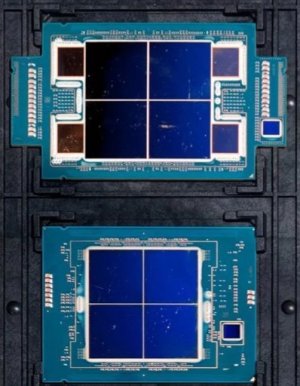

This is the first time I see these Side by Side. And yes the Compute tile on SPR-HBM is Larger.
So apparently the HBM version is sufficiently different that Intel said it's not worth the hassle applying the shrink they managed for the non-HBM tiles.
FMOhNpmWUAAV_WR.jpg:large
Where did the slide originate? The issue is that this slide could very likely be taken out of concept. This could simply be from an engineer proposing an alternate scenario in case of Intel fab issues, or it could be part of a slide deck providing all possible scenarios for discussion.
There is a reason it is marked “Not for External Communication“.
Companies I have worked at do similar slides when discussing the best path forward.
There is no way to know without context.

Faked Intel slides are very rare. We don't get much leaked Intels slides nowadays anyways. It shouldn't surprise anyone when Lion Cove+Skymont is made with a TSMC node in some of the versions. Even if it's not ARL-S there is Lunar Lake which I think Intel confirmed the external process in the slide from last year. It's suspicious Intel never really mentioned an Intel process when they referred to Lunar Lake. They are happy to tell us Clearwater Forest is coming with 18A in 2025 but didn't tell anything specific about Lunar Lake.
By using chiplets AMD managed to vastly reduce the amount of distinct dies they had to design for different markets. Intel somehow managed to achieve the exact opposite so far.
There's no way around it. The HBM version needs the memory controller/PHY that simply doesn't exist on the normal SPR die. So either you add a large chunk of silicon that 99% of your market can't even use, or you make another die.
