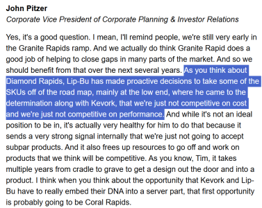

How does it make sense that they won't be competitive in performance on the low end, but will be on the higher end?
Only explanation I have is that per-core perf might be much stronger with Zen 6 than DMR, and in lower end skus where the boosts are also typically higher, you can really push that advantage, unlike in higher core count skus where you get limited by power-per-core much faster.
A little bit worryingly though, those lower end skus are also typically where the AI headnode skus are coming from. You don't need 192 or 256 cores for an AI headnode.

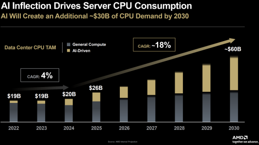

I was wondering what the demand is on the CPU in these AI nodes.
Since NVidia contracted Intel for high core count DMR and AMD is going to be using 256 core Venice in the Helios racks, I would think that you do need high core count CPU.
Interesting slide presented at FAD:

Has AMD confirmed they will be using the highest core count config of Venice though in their AI racks?
I'm basing my reasoning on Nvidia's current custom Intel sku only going up to what, 86? cores and 8 mem channels despite GNR maxing at 128. They also explicitly list high boost clocks as one of the optimizations made for that sku.
Prices and therefore margins are MUCH lower relative to SoC production cost on the low end.
The 2000$ SKUs aren't all that much cheaper to make than the 12K SKUs.
They probably expect Zen6 to be superior in PPW, max clocks, and thanks to SMT in terms of threads/MT perf per core as well.
Basically, in the high-end, margins are probably high enough Intel can stay somewhat competitive through price, without killing their margins entirely.
On the low end, margins already aren't that high, so there's just not enough margin headroom to compete against AMD entirely through competitive pricing.
I was not able to confirm that from the published slides, but I think that is the assumption
NVidia is using 2 Intel CPUs (Emerald Rapids) with 56 cores each for total of 112 cores.
I don't know if any specs for NVidia box with DMR have been released, but since DMR is cancelling low end configuration, it is a safe bet that NVidia will use the highest core count version.
Also, AMD is going with single Venice Zen 6 CPU per node, which to me suggests it will be the 256 core CPU.
