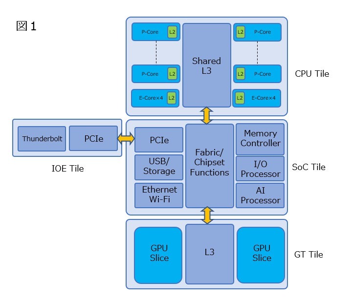

Wow, now that was a leak. Does Jim normally just drop stuff like that on Twitter?
C = Core = P-core = Performance-core
A = Atom = E-core = Efficiency-core
I think it's probably some combination of Thunderbolt and/or PCIe controllers + PHY. Maybe the IPU and PHY or something else imaging related.
As for why they'd put it on there, probably shoreline. Must be cramped in the main SOC die, and I'd hate to imagine what it would be like routing high speed IO under one of the active dies. Also, it could let them support different configs for different markets. P needs more PCIe, Thunderbolt, whatever? Well then just swap out that one die instead of the whole SOC.
As for the process, I'm thinking N6 or something similar. Curious whether they use internal or external for that.
That little tile is even smaller than what I said originally. It's only 5.1 mm x 2.0 mm = 10.2 mm². I'm guessing you're right about shoreline though. Despite the diminutive size, it still adds 25% to what's available otherwise on that SOC tile. As the dashboard posted above indicates, Intel refers to this as the IOE or IO Extension tile. I also found this MTL block diagram from a post back in January:
Intel also uses TSMC for discrete Thunderbolt controllers, so maybe, despite being on a different node, it was easier to maintain that block as a separate tile rather than integrating it into the SOC tile. Anyway, before I saw all this stuff, I made an image to demonstrate just how small that tile is by comparing it to the M1 Pro floorplan. The M1 Pro is on TSMC N5, but I increased the size of the red box a bit to account for the 6% optical shrink that Intel might be able to get with N4. And I realize Apple and Intel are using totally different IPs, but it gives you a sense of the scale at least—maybe three Thunderbolt 4 controllers plus a PCIe Gen4 x4 PHY would fit. But it wouldn't even accommodate a single 128-bit LPDDR5 interface.
I think this is converging in the right direction. Something like 2 TB4 + 4 or 8 lanes of PCIe for the M segment, maybe? And then you could make it longer to add more for P? I could see that. Definitely wouldn't want DDR on there, even if it'd fit. Too many hops.
