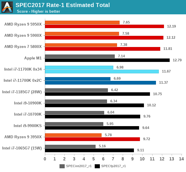

Numbers for small cores are not Spec_int but Spec_rate, wich is a full system test that take big advantage of bandwith.
