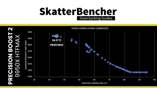

You're having trouble differentiating between "will" and "may", between direct and indirect causality:
  • high voltage/currents AND high temps WILL lead to degradation, these factors directly influence degradation
  • high frequency MAY lead to degradation if the parameters above are not properly controlled, this factor indirectly influences degradation
High frequency is safe as long as engineers set the proper boundaries for temps & voltage & current. Best recent example is the fmax/temperature plot for Zen 5, where everybody can see how much of an influence thermals have on max voltage settings, which then dictate the max frequency that can be achieved for a given temperature:
Max allowed frequency can go as high as 5945 Mhz @ 35C and then drop under 5400Mhz @ 80C+. And that's just an attempt to isolate frequency (voltage) vs. temps, introducing max current limits adds even more complexity.

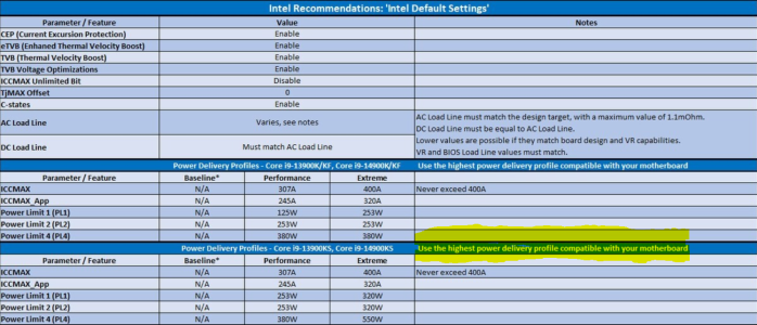

BTW a few moments ago I noticed that Gigabyte finaly published the BIOS for my motherboard with the 12B microcode. I updated the BIOS, fired up HW info to find out, that there are 320W power limits in place. Then I found out, that Gigabyte by default after the BIOS update runs the Extreme Intel profile, not Performance, is it a mistake or is it because I have 13000KS installed?
Hitman928
Apr 15, 2012
6,695
12,370
Limiting frequency so that the voltages the CPU needs are notably lower than the default Intel settings even after the microcode "fix", leading to much lower strain the CPU is subjected to.
Pretty sure the KS models use the extreme profile as the Intel default.
