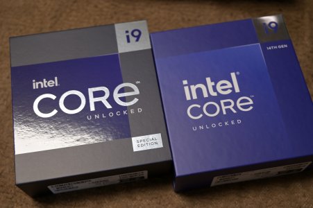

The SPECIAL EDITION box is way nicer!
I was wondering if it can be better than my 14900K. I tested CNB R23 4 threads at 5500/4200 MHz. 14900K required 1,320-1,343V, 13900KS 1,278-1,292V, so it is about 50mV better. At 5000/4000 MHz it was only 10mV better.

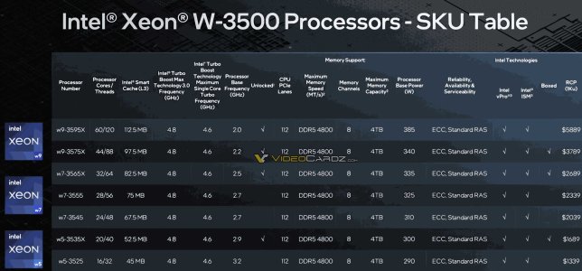

Are these CPUs made on the same process as normal desktop CPUs are?
Intel seems to think that for reliable workstation operation these CPUs can run only up to 4,8 GHz. That is 1,4 GHz lower than what 14900KS can run at.
Does anybody have experience with these CPUs, does this 4,8 GHz limit have any significance, or the "real limit" is even lower - 4,6 GHz?
The limit 5400 MHz I set on the new CPU suddenly seems way too high again... It is funny that everything seems to indicate that my "gut feeling" I got years ago that this process is good only up to 5 GHz was correct.

Are we really comparing an HEDT product with a 14900KS?
