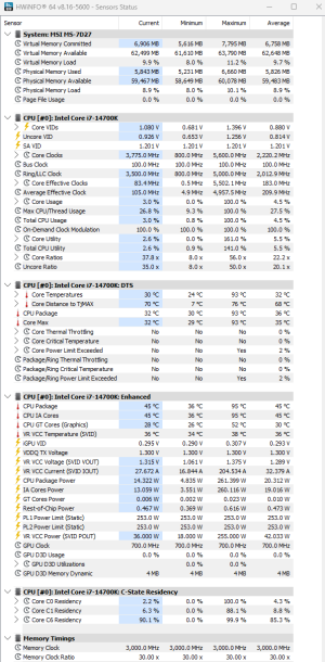

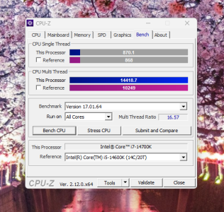

I upgraded my Z690 ACE system from a 12600K to a 14700K.
Theoretically it should be safe from degradation due to being on the latest BIOS as of today's date prior to even installing the CPU.
It has a 280mm AIO with a LGA1700 contact frame which appears to be barely sufficient to keep it from thermal throttling under full load.
The rig will be running 24/7 running Folding@Home on the GPU which is a lightly threaded workload for CPU purposes (usually) so I should be hitting max 1T boost with at least some regularity.
I will monitor for any degradation or instability.
