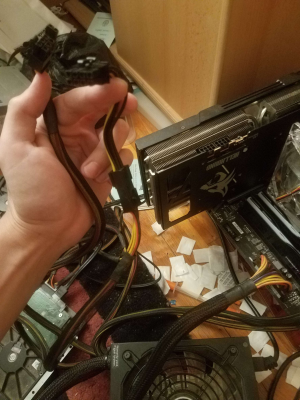

I have .an AMD Radeon 7900 XT and a 1,000 Watt Rosewill RBR1000-M PSU with connectors being from the PSU itself of 6+2 Pin & 6 Pin Cable which I use a 6 Pin to 8 Pin Converter (the GPU requires 2 8-pin Cables).. (Image 1 - Current Cable Hook Up)
My issue is that my computer crashes when I:
- Run an AMD Stress Test or Try to Manually OC the Card, the Computer shuts down and reboots.
- When playing High Intensity Games (the most modern one's), for example, Metro Exodus or Halo Infinite, the PC crashes, shuts down, and reboots..
SOMETIMES, instead of the PC shutting down & rebooting, the AMD Driver instead crashes, and I need to relaunch my AMD Driver.. (My Drivers & BIOS & Windows are ALL Up to Date)

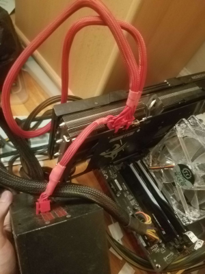

That computer, has an EVGA 1000 P2 PSU with a Custom Cable that says 600V VGA on it (image 2)..

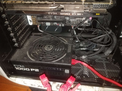

The custom cable is an 8-pin to 6+2-pin + 6 pin Cable (Image 3)..

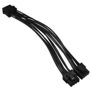

Unfortunately, the custom cable with the 8 pin PSU connector is NOT COMPATIBLE (does fit in) my PSU Rear (Image 4). BUT, the 6 pin part of the Cable DOES fit into my PSU, and the 6+2 Pin & 8-Pin PSU part of the cable, DOES FIT into my GPU..

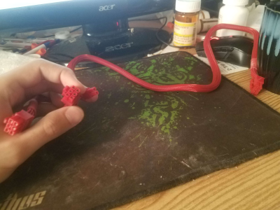

Will this have the potential to FRY my system (if I boot it like it is in Image 5).. (the 6 pin of the custom cable in the rear of the PSU and 8-pin from the other end + 6+2 pin), is that dangerous?

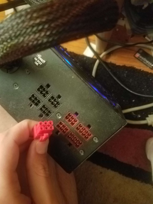

And if it is dangerous, would it be same to buy an ordinary cable to use for primary power supply to the GPU such as this cable? https://usa.banggood.com/20cm-Graph...pin-Extention-Power-Cable-Male-p-1931117.html (Image 6).
Yes, you risk fire.
You NEED to purchase a newer PSU (edit: WITH proper cabling), after you did A/B swap testing on your current PSU with that 850W unit.
AMD's high-end cards from 6000- and 7000-series are unfortunately relatively power-hungry.
