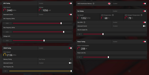

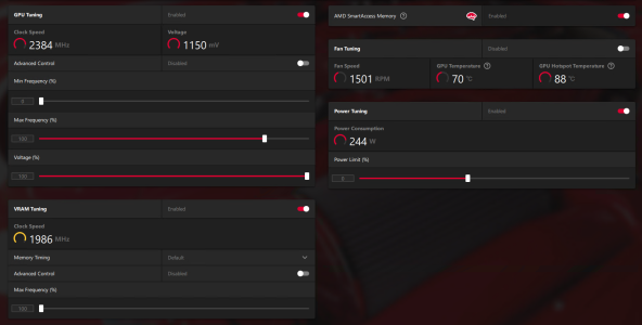

I have 2 6800XT GPUS set up this way and never seen any ill affects. The slider shows it is up 7% to . I ran Heaven Unigine for testing the settings. Instability shows up pretty easily in that benchmark. Perhaps the RX7000 series is different.
Yeah from what I'm reading thats what I though too , I'll be curious to see how overclocked his VRAM is. I was going to go to 2600, just up 100 and try it. but I don't think i'm going to touch mine.
Here are stock settings vs my OC settings. VRAM is only up 7% (150 MHz)
Stock (2429MHz is 100%)
OC

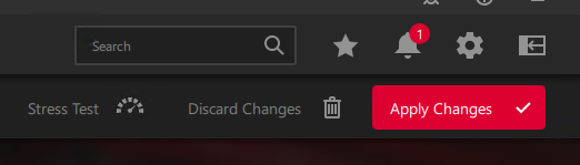

You are clicking on apply after making changes correct?
yes definitely.
