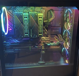

This is my build, I probably could have done some things better but it is what it is, I'm happy with it, I wish I would I have started looking into building a PC in the spring because i would have been up to speed but early summer on all the parts, I was to late starting and missed out on the summer sales, that cost me the 7800x3d, however I still got my case and AIO half the price of what they are now, and I was hoping to get a 7800xt and ended up getting a 7900xt for $880 to my door, which is really what I would have paid for a 7800xt. So i'm under 2k for my build. but I think I ended up with a better pc then i originally thought I'd have. I guess we'll see.
again Rigg and everyone else thank you very much for talking the time to answer all my questions and offering your help and opinions, I really appreciate it. i'm sure though I'll have more lol.
Your list is coming up blank for me.
