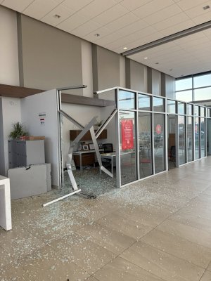

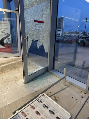

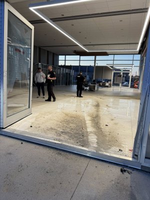

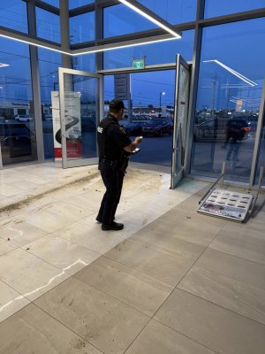

We just had the Temu version of killdozer, not much info about it other than a few pics from one of the victims. Apparently they hit up quite a lot of buildings at that end of town.
