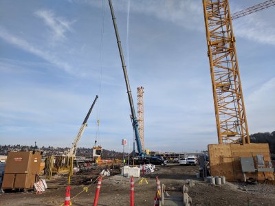

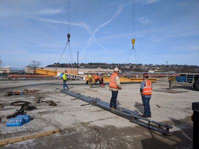

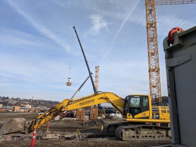

@yottabit, you are indeed barking up the wrong tree. There is only one safe way to do it for the people doing the work. Take shortcuts and this is one of the results. I worked on that job at the base of that crane.
https://en.wikipedia.org/wiki/Seattle_crane_collapse
Back to the premise that it takes weeks/days:
These are my pictures. This went up in a day while I was slinging forms with the truck crane nearby.
It takes two cranes, a small one pimping for the big one, and also two picking the jib assembly to get the pins in.
it is easier to pin those sections together when both are hanging on a hook. That's my boss in the near left.
I had lunch with those guys and about a month later two of them were dead in that accident above. :(
So that thing about how long it takes? It really depends. If they have to climb it down because it is out of reach, add a few days. But if you can get a hook on it you can pull the counterweights, the jib, and the counter jib in a day.
But it requires good weather. See that accident above.
