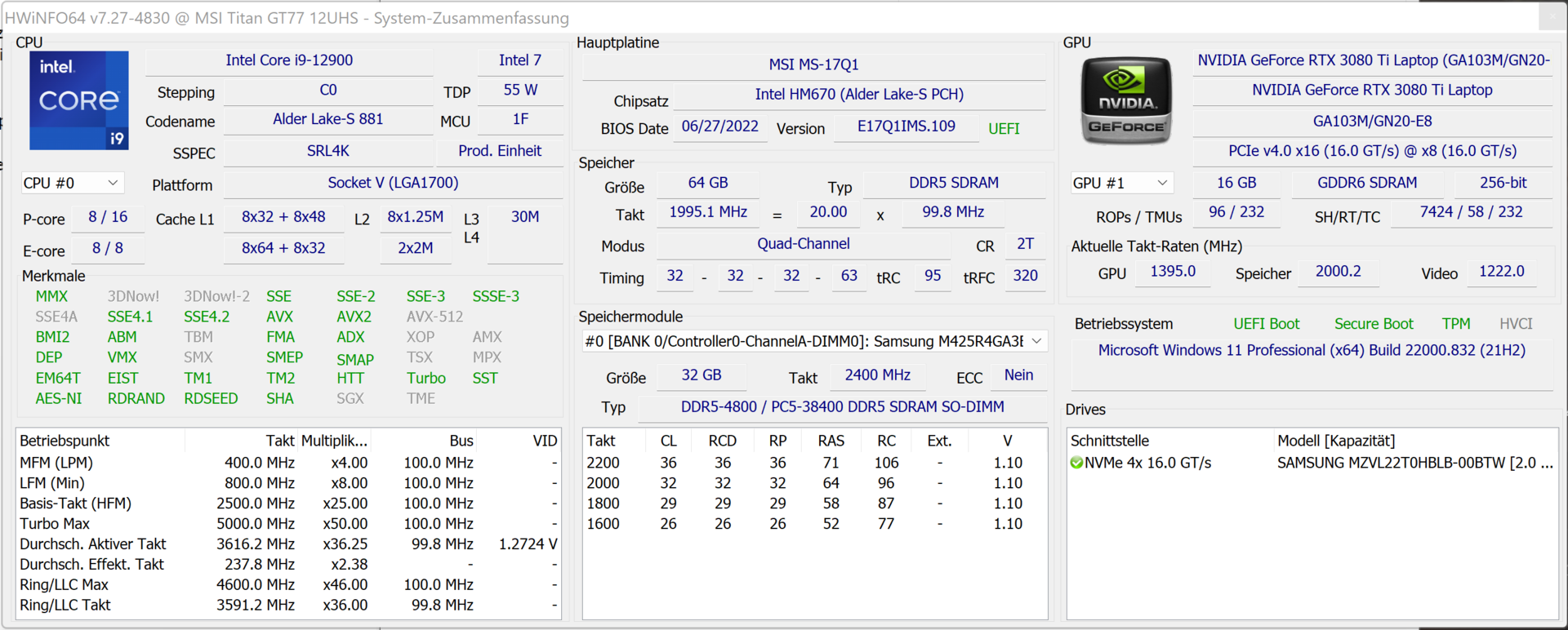

TESKATLIPOKA
May 1, 2020
2,696
3,260
The full chip. As in, something using Raptor Cove with 2MB l2 cache per core etc.
L3 is full 36MB, but they don't mention the amount of L2 on their webpage, only for desktop part.
On the other hand, the same situation is with Alder Lake mobile vs Alder Lake desktop, L2 is mentioned only for desktop part, but both mention L3.
It looks like It's not cutdown for Alder Lake, 14MB L2 and 30MB L3. I expect the see the same for Raptor Lake. If they wanted to cut down something, It would be L3.
