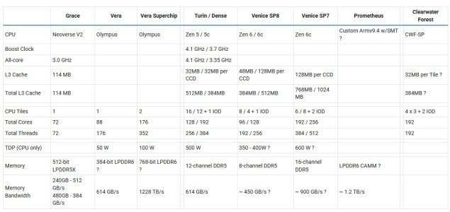

9. Venice 192-core (600W) -> Vera Superchip 176-core (100W) -> Prometheus
While I am trying to create a table listing potential Vera specs, Bionics and HXL has pretty much confirmed about Venice SP7/SP8 specs and TDP. Thanks to the leaks, I have pretty good idea about Venice platform which seems confusing at first. Let's go point to point:
  • First of all, there are 2 Zen6 dies: Zen6 with 12-core and 48MB L3 cache will be fabbed by N3P process, not N2 as last rumor leaked. Zen6c with 32-core and 128MB die will be fabbed by N2 process. Two Zen6 will be used for next gen client CPU; that make total 24 max core counts.
  • By doubling the L3 cache, Zen6c and Zen6 should share most of the features.....except clock speed due to extra 20 cores in Zen6c. More on that later.
  • SP7 platform will support 16-channel DDR5. So far there is one model leaked with 8 Zen6c die and 2 IOD. Each IOD should support 8-channel DDR thus SP7 requires 2 IODs.
  • SP8 platform will support 8-channel DDR5. By cutting half of memory bandwidth, SP8 could only support up to 128 Zen6c / 96 Zen6. Yep, it is lower than Turin Dense with 12-channel memory bus.
  • Here comes my understanding of TDP numbers. According to leaks, 256-core should come with 600W, each Zen6c should consume 50W and each IOD should consume 100W. That sum up total 600W.
  • 96-core Zen6 with 400W: Each Zen6 should consume 40W and IOD should consume 80W (without linking to other IOD). Total 400W.
  • 128-core Zen6c with 350W: After deducting 80W IOD power, each Zen6c die should consume 67.5W which is higher than Zen6c in SP7. My thinking is AMD might try to clock Zen6c higher so that the difference between 96-core Zen6 and 128-Zen6c will be as small as possible. Thus, AMD could command higher price tag for 128-core.
  • 192-core Zen6c with 600W: Bionic believe Zen6 die will be used in SP7 platform. I don't think so, there is no point putting more than 8 dies in SP7 when Zen6c is able to fit in the core counts. What we are lacking is HP Zen6c: And if we apply 67.5W with 6 dies, we get total sum of 605W. Thus, I believe AMD will use 6 Zen6c die to create high performance 192-core...
Reactions: Darkmont and marees
  • SP8 platform will support 8-channel DDR5. By cutting half of memory bandwidth, SP7 could only support up to 128 Zen6c / 96 Zen6. Yep, it is lower than Turn Dense with 12-channel memory bus.
  • 96-core Zen6 with 400W: Each Zen6 should consume 40W and each IOD should consume 80W (without linking to other IOD). Total 400W.
  • 128-core Zen6c with 350W: After deducting 80W IOD power, each Zen6 die should consume 67.5W which is higher than Zen6c in SP7. My thinking is AMD might try to clock Zen6c higher so that the difference between 96-core Zen6 and 128-Zen6c will be as small as possible. Thus, AMD could command higher price tag for 128-core.
  • 192-core Zen6c with 600W: Bionic believe Zen6 die will be used in SP7 platform. I don't think so, there is no point putting more than 8 dies in SP7 when Zen6c is able to fit in the core counts. What we are lacking is HP Zen6c: And if we apply 67.5 with 6 dies, we get total sum of 605W. Thus, I believe AMD will use 6 Zen6c die to create high performance 192-core...
Your Vera specs massively underestimate TDP. (Also, Vera doesn't have LPDDR6, AFAIK. It has LPDDR5X and, bizarrely, DDR5, though I have no idea if the latter will be enabled in released silicon.)
Yep, 50W is the TDP numbers given by Jensen. I suspect it means CPU cores only excluding memory controllers. I will put question marks for Vera SoC. As for memory controllers, LPDDR6 is coming real soon. Vera which is coming by end of 2026 should utilize LPDDR6, we shall see..
1) I highly doubt it's 50W for just the CPU cores unless they were not very performant cores (And as we all know, Jensen would never lie... Right guys... Right?!?!)
2) Vera isn't LPDDR6, it's LPDDR5X... likely LPDDR5X-9600 on a 512b bus...
I think what is going on is that Vera will support CXL on its PCIe lanes and you will be able to attach DDR5 modules to Vera via CXL.mem.
Which makes sense for Vera considering that it is just a memory expander for Rubin.
