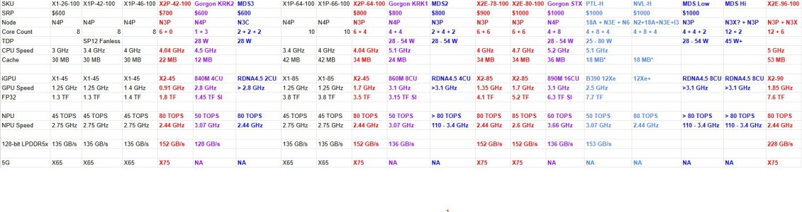

Above spreadsheet is created by me to compare Qualcomm and AMD mobile APU lineup. Qualcomm only need 2 dies to offer their WoA APU from top to bottom. FYI, Gorgon Point consists of 3 old dies: STX, KRK1 and KRK2 which will be replaced by MDS1, MDS2 and MDS3. Each die will be upgraded to support XDNA3 >80 TOPS: a feature also decoded by me before AMD's FAD. AMD seems to make changes in the CPU configuration to accommodate changes in iGPU and NPU. Still MDS1 (18 threads) is more than NVL-H (16 threads), it is the changes in iGPU I will be talking today.
The amount of CU will be cut by half in MDS1-3, do you really think AMD is going to use same old GPU architecture in newer N3P node: the same node as upcoming RDNA5? Here is my speculation, AMD will double SP per CU; thus the FP32 TF will remain if AMD is maintaining the clock speed which seems unlikely. For x86 APU, AMD will set higher clock speed for its iGPU and NPU: the removal of 4 E-core might be the indicator.

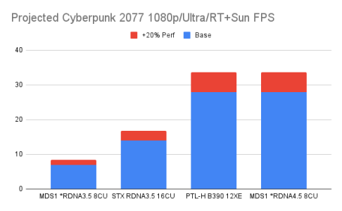

Projected iGPU - Cyberpunk 2077 (1080p/Ultra/RT+Sun Shadows)
For those who do not understand how laughable if MDS1 is using RDNA3.5+ 8CU as iGPU, I created a stacked column chart listing the projected FPS based on data from DF. Each column comes with 20% faster FPS due to higher clock speed. PTL-H +20% is estimation of NVL-H with 12 Xe+. Even with +20%, MDS1 with RDNA3.5 8CU cannot even break 10 FPS. The reason is due to poor RT cores from RDNA3 generation. Do you really think AMD will bundle such old technology in APU which will be available from 2027 towards 2029. Hoho, use your brain for once, please. :p
I already estimate 3 times faster Radiance core in E2600's. By simple calculation, MDS1's RDNA4.5 iGPU's performance is comparable to PTL's B390. Clearly AMD is sandbagging the performance of iGPU. As I said, don't believe what the roadmap told you. The amount of CU is correct, just the RDNA generation is not. Juno IP is the next generation graphics IP from AMD which should be similar to RDNA4.5 which itself is subset of RDNA5. That's my assumption, let's see how truth it will be. :cool:
sir just one example
Vega GPU was released 2017
AMD was launching products with that igpu even after 5 years
AMD Ryzen 7 5700G Processor with Radeon Graphics Mini Review​
Posted by Sebastian Peak | Jun 28, 2022 |
Now do this calculation:
RDNA 3 launched 2023
expect igpus for 5 more years until 2028
from 2029 onwards RDNA 5 should start taking over (except for embedded systems)
