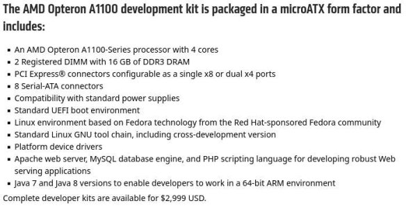

It is cheaper than AMD's Seattle (4-core Cortex-A57) DevKit by $500.
By 2016, the same configuration dropped to $599 in the Softiron Overdrive 1000. Which never released I think because the board manufacturer switched to HiKey 960 instead.

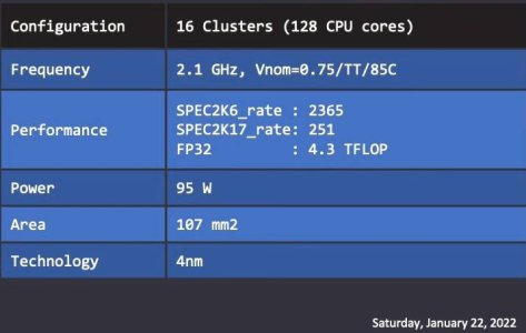

The one to watch is actually the SG2380, which is $120 after "【Pre-order】Milk-V Oasis - 16 Core RISC-V Desktop Coupon Code" and should be $150? w/o the "20%" coupon. Which is cross-compatible with RVA22 <-> RVA23 <-> RVA24. The chip still has awhile to be physically available allowing it to get RVA23 and OS-A23 Common in. OS-A Common: "The OS-A platform specifies a category of rich-OS platforms that support operating systems like Linux, FreeBSD, Windows and more" Which is why it is likely the platform to develop generic-image drivers on Windows for at least Imgtec/Radeon GPUs.

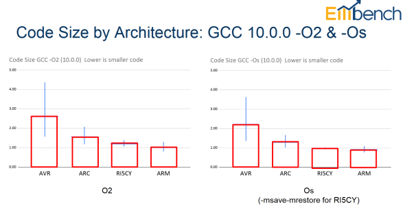

First - lower size is better, but so is lower dynamic instruction count.
Second - that's comparing against ARMv7 with Thumb2. ARM64 is a different ISA.
Third - I'd advise looking at Qualcomm's more recent and relevant slides on this subject, especially the last one of their presentation.
RV is not a great ISA.

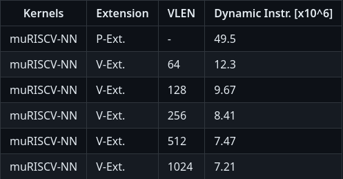

Just note that it is just with the C-extension. Where RVV greatly reduces code density and dynamic instructions: VLEN=64 equals VLEN=128 LMUL=1/2 && VLEN=512 LMUL=1/8 && P-ext(not-ratified-not-frozen-in-rework-from-scratch). Which is why just C has higher instruction count, as it is doing SIMD work on Scalars.

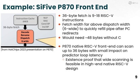

2. C doesn't increase decode complexity by that much, because you need an uop cache anyway, and you can just expand compressed instructions to the equivalent non-compressed ones.

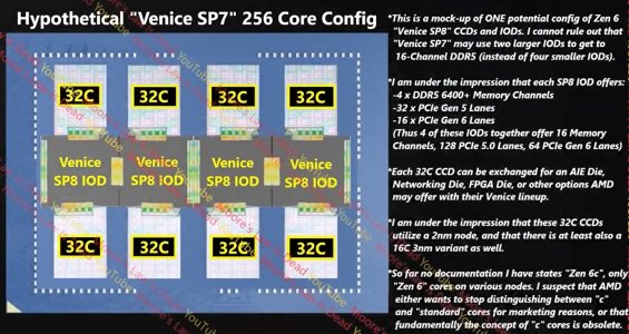

If anyone is still reluctant to believe AMD's future APU is based on ARM core, here comes more scary future for you: :eek:
Venice is upcoming AMD's EPYC server platform after Turin. Venice platform could support up to 256 core counts as shown in the mockup picture from MLID:
Zen 6C is going to be manufactured by TSMC's N2 process, the most advanced process TSMC is offering in
2026. AMD have to opt for it cause with doubling cores, TDP will hit higher. Turin platform supporting 128-core (with 16 pcs tCPU) have 600W TDP per socket. I think Venice platform with 256-core would be the most core counts AMD going to offer for x86 server platform. How about lineup after Venice?

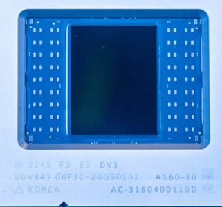

Let me show you Ampere Computing's latest cloud native server CPU: AmpereOne with 192-core CPU that is built by TSMC's N5 process:-
The CPU is a monolithic die with 192-core (shown is A160-30 means 160 cores @ 3GHz) at 350W TDP. Can you imagine if AMD choose to use ARM core with N2 process, how many cores AMD able to fit in within 600W TDP? That's the reason AMD will switch to ARM cores in the future, same as client SoC.
Like Ampere, AMD should embrace an Arm architecture license which offers greater freedom. You may ask how about OS support? Qualcomm and AMD have entered ARM server CPU before, without OS support, what is the point?
