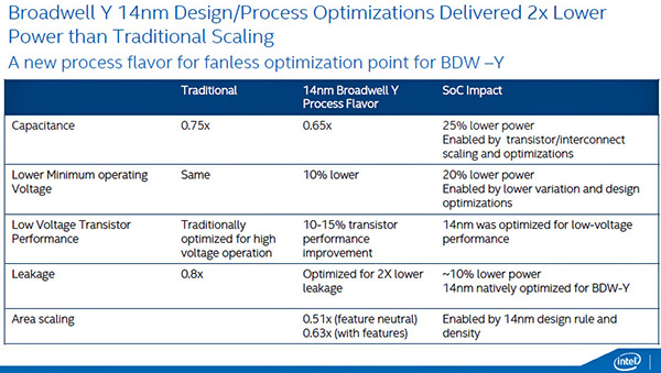

* There is a trade-off between IPC and frequency. The most extreme example of this is Apple A10, which has until A8 been on very low frequencies. Generally, a longer pipeline means lower IPC but higher frequency, and vice versa. (Source.)
* Clock speed is also impacted, of course, by the process node. FinFET is known to have slightly different IV characteristics than planar FETs. Particularly, FinFETs have a steeper sub-threshold slope, but lower post-threshold slope. This has caused 22nm Ivy Bridge, Haswell to reach lower frequencies than planar 32nm Sandy Bridge. (Source, article).
* Both high-level architectural as well as process choices can be mitigated by low-level, nitty gritty design choices and optmizations. A very stunning, telling example of this is Intel's 14nm (non-plus) Tick-Tock generation Broadwell and Skylake. Broadwell-C, which came from the very mobile focused Broadwell-Y lineage*, didn't reach high clock speeds, in a similar vein to how the 22nm generation had done, but the Skylake architecture has reversed that trend and has, at long last, equalled SB frequencies.
That last point about Skylake clock speed was actually predicted by AT forum member III-V, and is now being confirmed again by the Kaby Lake 14nm+ generation. So SKL/KBL frequncies are a combination of the 14nm process (and certainly the 14nm+ one) being better than planar on all levels because of the improved process and because the fin penalty was only a one-time tax, and because of the architectural focus on high performance.
