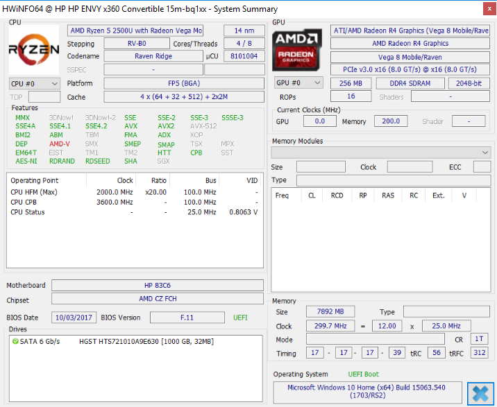

I'm not sure why this thread became about Intel and/or AMD lying about TDP. At the very least, we don't have any evidence of that for RR. The 2500u is rated at 15W TDP with a 25W cTDP. Whether the cTDP modifier is active is up to the OEM, not AMD. And, the same issues (boosts, cTDP, ect.) complicate analysis of performance within a particular TDP for both Intel and AMD parts.
Something to keep in mind about the R15 scores for the 2500u, according to the NBcheck review they were rock steady at ~560-570 over many runs. The Intel 8250u and 8550u notebooks varied widely from 480 to 650, which huge differences over multiple runs. All in all, in makes it very difficult to compare the efficiency of the parts.
