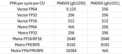

Yeah there's MI450X with nerfed Vector FP64 and no Matrix FP64 and MI430X with double rate Vector FP64, Matrix FP64 and no Matrix FP4/6.
So are they going to be diverging the ALU design between MI450X and MI430X?
Because as of CDNA2 the ALUs are 64b native ALUs not 32b native ALUs... so they would need a different ALU design in order to do what you are suggesting without it still physically being there...
Yeah these are the FMA rates AFAIK:
So... if it's the 1/32 like you said then it should be 8 FMA per cycle per CU for GFX1250...
I am also going to question that they are getting rid of the extra ALU lanes that GFX1200 has along with cutting the matrix performance significantly... By the math you have there, assuming it's FMA ops per cycle per CU and not FLOPS per cycle per CU, then they are cutting the FP16/BF16 Matrix performance in half compared to CDNA4... If you are talking about the FMAs per clock then it's a halving of the FP8, FP6, and FP4 Matrix FLOPs per cycle and a quartering of the FP16/BF16 Matrix performance compared to CDNA4...
And I am doubtful that they are going to spend the RnD time for the different GFX125X ALUs... That isn't AMD's style...
I personally think you are extrapolating far too much from Github repos...
