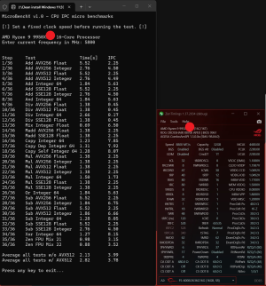

I ran the following on my X3D
5.8 static
2200mhz FCLK
8800MT/s GDM disable "synced with FCLK"
Now we get to the more interesting part in my opinion, IPC comparison.
I am not familiar with the benchmark you have run, but looking at the screen output it looks like it's measuring the instruction throughput per specific operation (compare the scores against the instruction tables, they mostly align) what could be technically called instructions per clock but it deviates from what other people measure as such.
Of course I might be nitpicking, not knowing the code I am just speculating based on the output screen😉. But if I am right, then Skymont should average higher IPC there than both Zen5 (x3D shouldn't matter for these tests) and Lion Cove on specific tests, simply because it has 4 fma units.

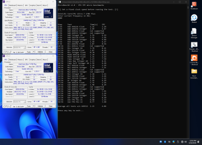

Not sure anyone are interested, but we did a little IPC comparison over over at the overclock.net forum with a tuned Arrow Lake refresh system and tuned Zen5X3D system.
Turns out the IPC between these two architectures was alot closer than what i expecting when pushed with maxed out fabric and memoryspeeds.
I also think this matter when we are trying to predict the future battle between Nova Lake and Zen6, as the going forum mentality is that Arrow Lake already have ~10% higher IPC than Zen5 (?)
We used MicroBenchX_v1.0.5 to compare our systems, github page can be found here:

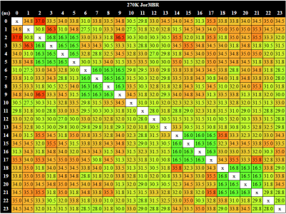

First we compared the core to core latency between our systems, but not really anything unexpecting there.

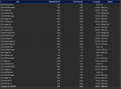

tuned 270k @ 5600mhz
tuned Zen5X3D @ 5800mhz
When compared side to side, it turns out Arrow Lake average IPC only was ~1.2% higher than Zen5XD
If Nova lake only gets lets say +15% IPC and no clock speed increase, and Zen6 gets +10% IPC together with a +20% speed bump Intel will be in really hot water for anything not embarrassing multithreaded. (atleast when comparing overclocked systems)
But then again, have no idea how trust worthy this MicroBenchX_v1.0.5 benchmark from seemingly capframex really are.
This is great work. No matter what you do people will pick it apart. You isolated various routines and calculated IPC and people will complain it's not actual applications. If you use actual applications they will claim you should have isolated specific routines, etc... You can't win with the armchair quarterbacks.
This is an EXCELLENT analysis and lines up well with my post regarding IPC where I find ARL and Zen 5 are pretty much even. They are stastically on average a draw.
