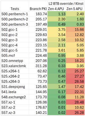

Geddagod
Dec 28, 2021
1,681
1,718
Simple, you are having to feed a much larger frontend... you expect more L1i misses assuming the same structure size...
But by such a large margin though?
Do we have any reference to other architectures that kept the same L1i capacity but massively increased the front end? GLC vs SNC could be a good comparison, considering they also doubled the L1i bandwidth, kinda like Zen 5 due to the 2 ahead BP?
So that is very dependent on the workload, for example compiling the Linux Kernel the L2 BTB overrides went down from about 12.86 MPKI to about 3 MPKI... where as the L1 iTLB misses went up which again isn't surprising considering that the L1 iTLB size didn't change from Zen 4 to Zen 5...
The only specint2017 subtest where L2 BTB overrides went down in Huang's testing was 500.perlbench 2. 500.perlbench 1 and 3, as well as all the other specint subtests he ran, saw a large L2 BTB override increase.
