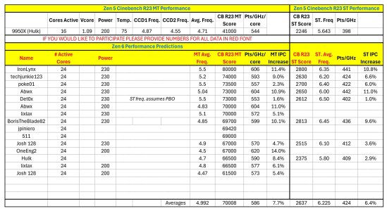

Sure. I was thinking there would be someone brave enough to take a guess already now, based on process tech, arch, core count, or whatever. I mean people are brave enough to out their perf estimates in the Hulk table.
In my case I’ll probably evaluate Zen6 vs NVL-S at approx 120W and see which one performs best. For me it’s not worth almost twice the power consumption as needed when maxing it out, just to get 10-20% extra perf or whatever.
I'd guess that there are three main factors that will have a big influence on the Performance-Power Curve of Zen6 compared to Zen5:
Obviously the new process will generally give you more Performance for a given Power input. So, the whole curve will get elevated a bit.
The new interconnect will lead to a smaller part of IOD consumption which might be pretty significant for let's say below 80w. So the curve will start higher and be less steep in the left half - a bit more like the curve of the 285K in your picture.
The core increase will keep the per core consumption in a more efficient range for longer. So even at 200w total consumption, 24c will not be as much in the diminishing returns as 16c are today. So from 80w to 200w the curve should be steeper than today. For when it will start to flatten, I obviously can't say.
So all in all I am expecting the curve to look more like the 285K but without the kink (is there an explanation for this?) and altogether on an elevated level.
This should also mean we'll hopefully get quite an impressive MT perf increase going from Zen5->Zen6 at default TDP.
Given two node jumps and 50% more cores, a 40% MT improvement at ISO power does not seem too optimistic IMHO. If things (the node jumps especially) go well and IPC % improvements come with less % power increase (as AMD always targets), it might be even significantly more.
We should get that, at a minimum, but it will 100% depend on the power level chosen. The performance delta will be greater at 230W than it is at 200W for example. While Zen 5 doesnt scale much from 200 to 230, Zen 6 certainly will. Likewise, delta at 65W or lower could easily be 150% or more if AMD cuts idle power to sub 15W for Zen 6.
Performance delta might look like below due to those two factors above. It could be a strange phenomenon where you either want to be very low or very high power to get the best perf deltas , with middling power levels having the worst.
Absolutely agree in this.

To add to the guessing game:
24c / 230w
ST: 2.813 / 6,45 GHz
MT: 69.700 / 4,85 GHz
Sorry for the edit after posting.
I like your outlook on ST. This is what everyone here is hoping for, I just cant bring myself to really believe it will clock any faster than 6.2ish. I sincerely hope Im wrong though.
