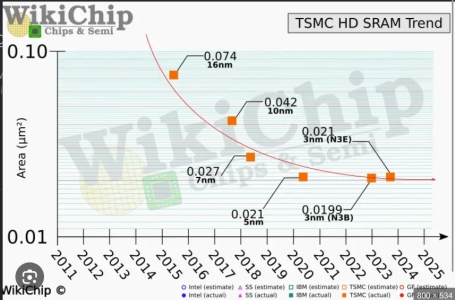

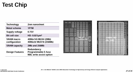

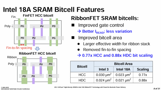

N2 = 38 Mb/mm²
vs
N3E/N4(x)/N5(x) = 31.8 Mb/
~20% more bitcells per mm²
Edit: Well, that's certainly interesting. I honestly expected Z7 to be more of a "tock" than a potential industry gamechanger. But TBH, I followed exactly 0 leaks on Z7 until now. As early as this year's CES I wasn't even sure AMD will continue with the Zen moniker, hence I didn't bother to look up if Zen7 even exists as e mention from credible sources.
It makes little sense for each core to have a distinct own L3 die. Wouldn't it be simply easier to produce just moving the whole L3 to separate die beneath the compute die? I mean they can tune the layout to ensure that each 7MB segment lands underneath a corresponding core making it tad faster to access but should be easier to produce and ensure that that no additional synchro is needed between smaller L3 dies. It might be I have misread the leak though.
That is Macro not the bitcell which i was referring to.
Ah OK.
But the end-result is still an improvement? They're making the arrays/periphery/I-O that house SRAM more efficient (that's what the macro SRAM structure entails, no?), so more N2 cells can fit in the same space a N3E/N4/N5 chip would have allocated.
That was mostly my point, don't think I even mention bit-cells specifically and I'm too lazy to check right now lol
Also, now I wonder how that would affect the 3D stacking? Has TSMC further optimized N7-SRAM node for N2 use? Anyway, I might just be splitting hairs at this point.
