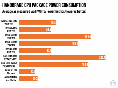

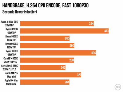

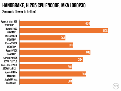

It’s interesting to note that Ars also had similar results, in fact I would say the 9700X was doing much better relative to the power consumption when compared to the Max+ 395 in Handbrake.
Note: All AMD readings include the package power.
However the 9700X did poorly against the Max+ 395 in Cinebench/Blender.
