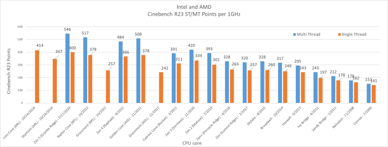

Sorry, it was greater commentary since I have been bombarded with R23 everywhere for every cpu release recently it's like other benchmarks almost don't exist.
R23 is very predictable benchmark and usually easy to replicate. It has a use: to show how much throughput a chip can achieve in an embarrassingly parallel workload.
I'm not arguing it should influence buying behavior. Just that it has at least one use. Perhaps other benchmarks do it better but it's so easy to install and run that I use it for testing cooling.

Hulk
5,271
3,957
It's also nice because no installation is necessary. R23 is so much more fun to watch than R24 too.

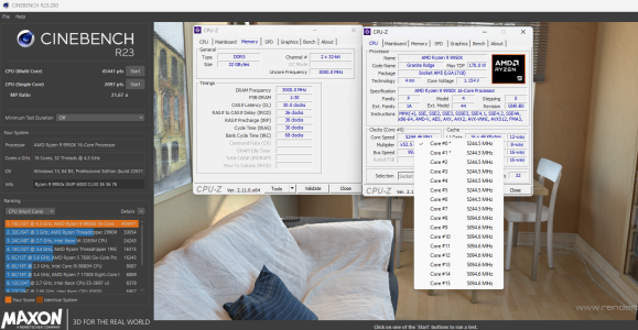

Josh128
Oct 14, 2022
1,505
2,256
I decided to do a quick run at static 5GHz 1.1V setting, all else equal to my last run. This is by no means the lowest Vcore I can use, just one I picked up looking at auto PBO voltages.
Nice score increase in multicore and much lower load power at the same time, I like. ASUS allows me to set profiles with boost still active, might play with that later ;)
Agree, R24 is incredibly boring and long.
