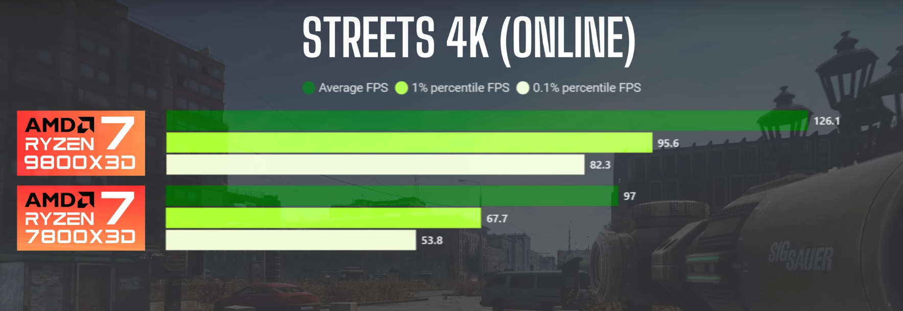

CPU games
Also bonus Escape from Tarkov

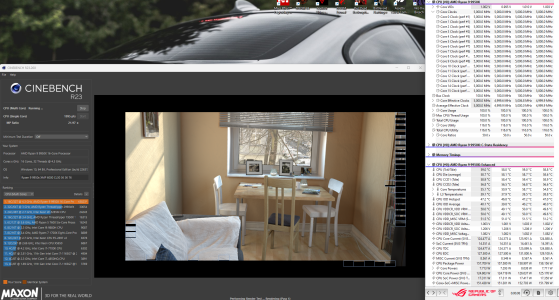

I detuned my CPU to give you some answers :)
MB stock settings all AUTO apart from memory which is on A-Die profile, but nothing crazy.
Watercooled with a Corsair XC7 block and 480mm + 360mm rads (makes no difference to CPU temps compared to standard AIO 240mm at these settings).
Fantastic! Thank you.
Finally an apples-to-apples comparison with my 14900K, also all auto except for XMP I for my DDR4 memory.
Okay here we go.
I assume you set power limit at 200W? That's what my 14900K is set at also we have the same power.
Looks like the 9950X is running 8 cores at 5GHz and 8 at 4.65GHz for an average clock of 4.825GHz. Do you know why the 9950X runs some cores higher and some lower? Seems like efficiency would be better if all cores were run at the same frequency, right?
Anyway, my 14900K runs CB R23 MT at 4.6GHz for the P's and 3.9GHz for the E's at 200W package power.
My temps on Assassin air is 83C max package. Yours with much better cooler is 72C.
What temp do you think my Assassin would do at 200W with the 9950X?
Scores, 35k for the 14900K and 42k for the 9950X, both at 200W.
So there you have it. At the same "real world" power number of 200W (around where I think most people run these parts) the 9950X is about 20% more performant than the 14900K. I write "about" because different samples (bins) will perform differently, but I think this is a good comparision we have here. Stock-for-stock at 200W.
I bet the 9950X would score 35k on 125-150W.
The 14900K only gets ridiculous with power when you push it over 5GHz on the P's.

It is normal to have that much frequency difference between CCD's?
My sample is scoring well, but it has large spread between CCDs.
Lower clocks on 2nd CCD are normal, all dual CCD Ryzen CPUs behave like this as one CCD is picked for max. freq. and the other for power efficiency.
Obviously, with Core Optimizer at -30 for CCD2 and PBO bumped to 220W 2nd CCD maintains 5GHz in Cinebench with ease.
As for cooling, this CPU runs cooler than my 7800X3D ran and definitely cooler than 5950X when set to 200W.

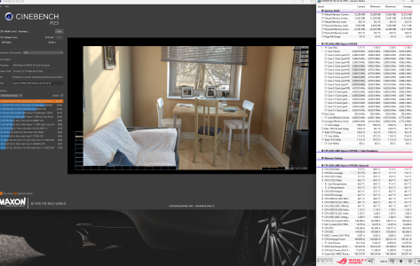

I decided to do a quick run at static 5GHz 1.1V setting, all else equal to my last run. This is by no means the lowest Vcore I can use, just one I picked up looking at auto PBO voltages.
Nice score increase in multicore and much lower load power at the same time, I like. ASUS allows me to set profiles with boost still active, might play with that later ;)
Wow! 158 Watts, 5GHz, and a score of nearly 44,000.
