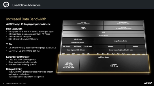

But it's still limited to 2x128bit loads for SSE2 code like most x86-designs. Only Skymont will be able to do 3 128 bit loads. Those 256 and 512 bit loads won't help at all with SSE2.
Right, the program I run doesn’t take advantage of the wider vectors afforded by AVX2 and definitely not AVX512, hence why I think I’m L/S bound.
I’m really interested in Zen 5 since it appears to handle a mix of 4 loads/2 stores per cycle, which is readily evident to me that it can truly handle two threads at full throughput. Again, more evidence that Zen 5 was designed for SMT from the get-go. My company sources our servers through Dell, so it shouldn’t be long before Turin is available for purchase. Would love to get my hands on a dual-socket R7725 blade with dual EPYC 9655. I’m in charge of one of our internal analysis committees so I have a little bit of sway on our server hardware choices. :p
Only 2 pipes are able to do SIMD loads/stores. In general you can do at most 4 mem ops of which at most 2 can be stores. You can do at most 2 SIMD loads per cycle or 2 SIMD stores (only 1 for AVX512).
Also if your code is really pure (pure part is important here) SSE2 only then it doesn't use FMA units at all. If it is in your power I would really reconsider recompiling it to something newer. You can use 128b vectors with AVX2/512, compiler will actually emit FMA for these and it will have 16/32(AVX512) architectural registers to play with instead of 8.

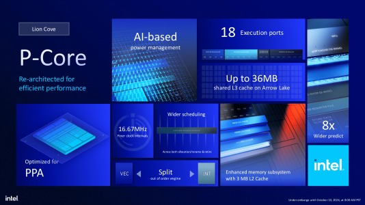

because it's basically free performance at same power. Which makes it even more unbelievable that they removed it for new consumer CPUs.
The aspect of performance per power is only one of the reasons for implementing SMT. It's nice to get it without increasing power usage much, but even at linear power increase it would be desirable because that's better than the less than linear performance-per-power increase at high frequencies. The other argument for SMT is more performance per area because the additional transistors require much less area (around 5%) than they add in performance (15-30%). The source is this document, and the money quotes are:
This implementation of Hyper-Threading Technology added less than 5% to the relative chip size and maximum power requirements, but can provide performance benefits much greater than that.
Measured performance on the Intel Xeon processor MP with Hyper-Threading Technology shows performance gains of up to 30% on common server application benchmarks for this technology.
So...
The main takeaway for me is that Intel removing HT still doesn't make sense, because the performance uplift should still be higher than the die area required.
Why do I say this? Because Intel says "Optimized for PPA" on their slide for the Arrow Lake P-cores:
This. Doesn't. Make. Sense.
And sorry for this now basically being a post for the Intel thread, but we are also discussing AMD's more effective implementation of the same technology.
So...
Maybe the simplest answer is correct: removing SMT simplifies validation of the design, and makes it easier to schedule threads between the P cores and the E cores. That’s it. Anything beyond that is just marketing so that the consumer doesn’t feel like they got a downgrade.
