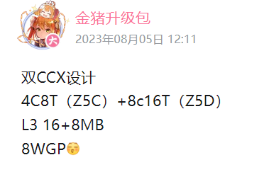

Golden Pig Upgrade pretty much confirmed the specs of Strix Point coming next year.
Hmm, based on total cores with L3 cache improvement and 8WGP (or total 1024 SALU), the die size would be much bigger than 178mm2 of Phoenix Point

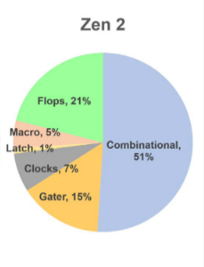

As for 1:1, I also don't understand how this is possible. This is Cac distribution for heavily optimized 7nm in Zen2 from their slides. 22% is accounted for clock tree and gaters, and that's just the Core
